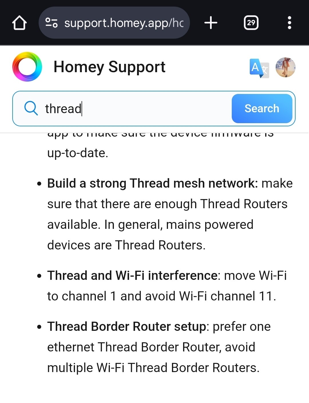

I haven’t got a real life example, but according to Athom knowledge base,
any Thread FTD, with router functionality, should do
https://support.homey.app/hc/en-us/articles/12934291420060-Connecting-a-Matter-or-Thread-Device
