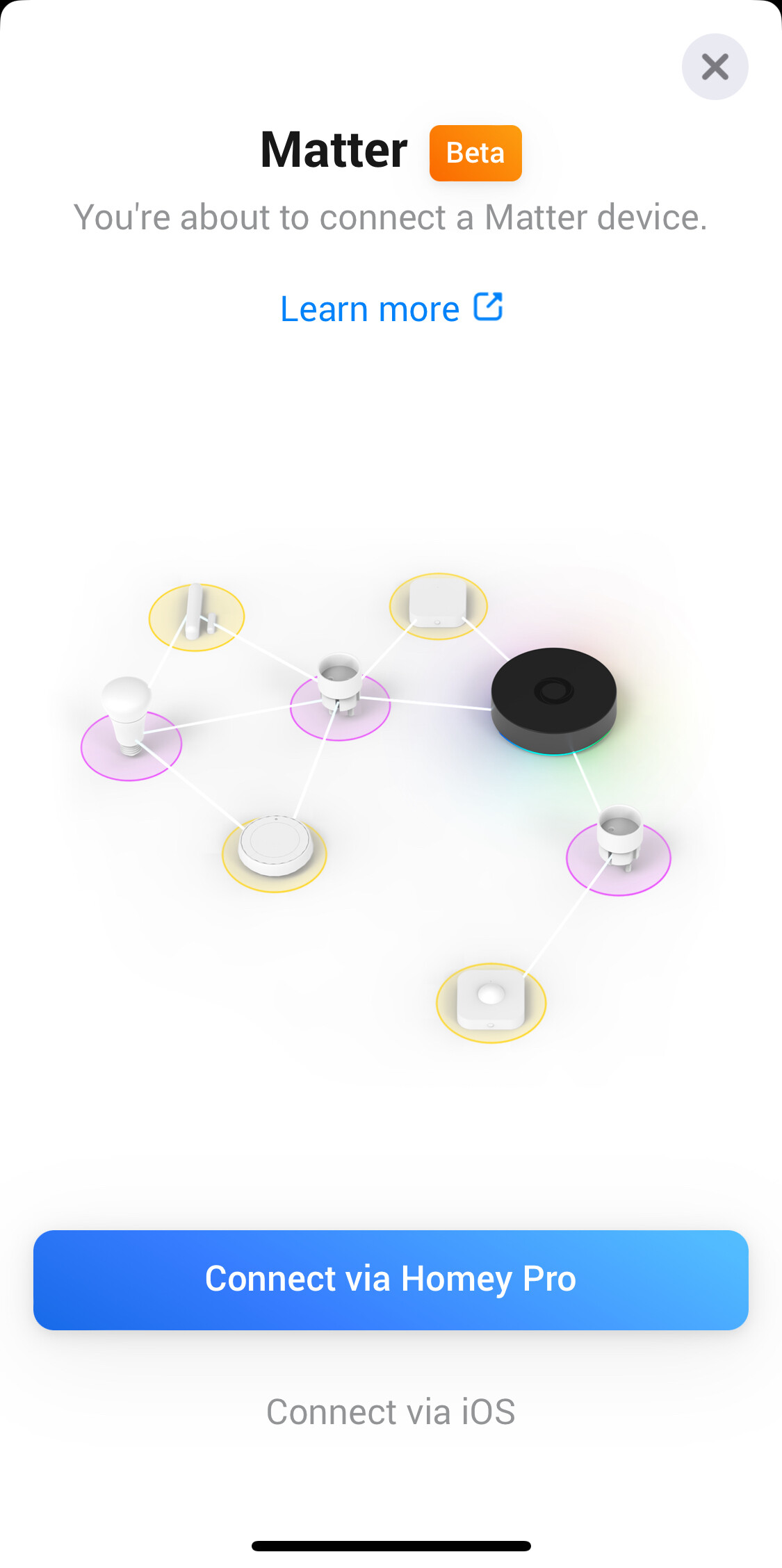

In the mobile app (won’t work in the web app), go to Devices, “+”, “New Device”, “Matter”.

With the Homey app for iOS you have two options: “Connect via Homey Pro” and “Connect via iOS”. I don’t know what the difference is.
I have the same option in Android. Thing is that the qr code for Matter has 11 digit. The one for homekit is 8 digit. So I assume Matter is not the case here
