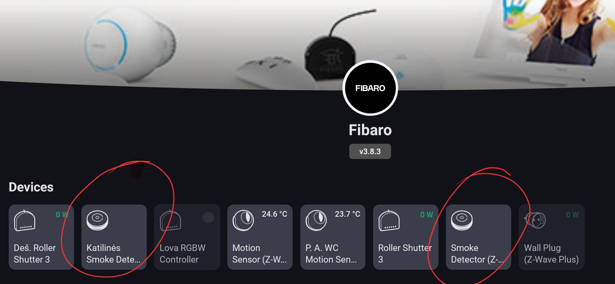

As a side note, the Fibaro smoke detectors are very neat because of their size and design, I have one already at home. But you cannot seem to trigger the alarm on all of the fibaros, but it seems that the tuya smoke detectors have corresponding action cards.
