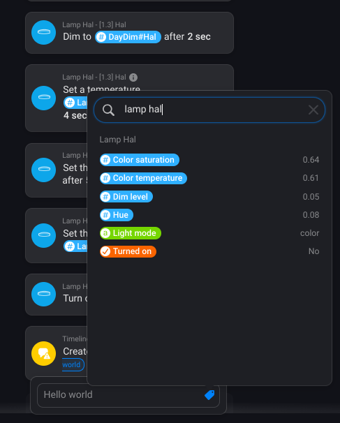

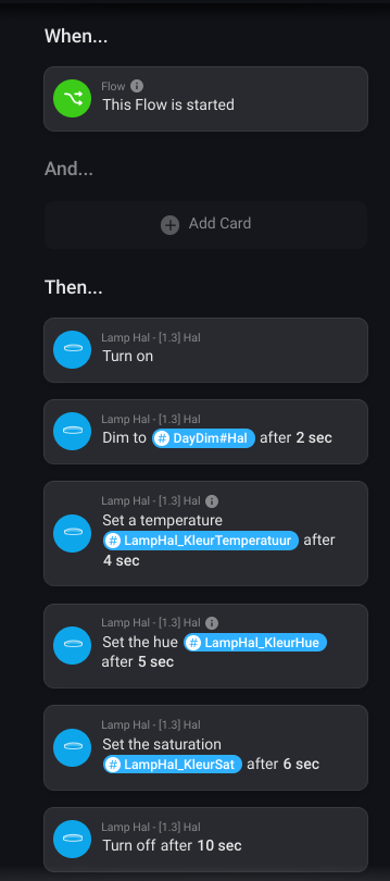

This is a way to do it, I have a light which shines ‘normal’ most days, which can do party mode as well.
What I did, I noted all the values and store them in variables.
With a flow to set the light to ‘normal’ again, I set the colors and stuff to the values from the variables.
I retrieved the ‘normal’ light values by hitting the ‘tag’ icon in a timeline card, and search for the light

Well, maybe the app is not exposing or not using the mode property. In any case, setting saturation to 0 basically is “temperature mode”.
