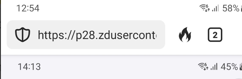

Also this site
Is absolutely nothing I recognize as a Athom or Homey site.
