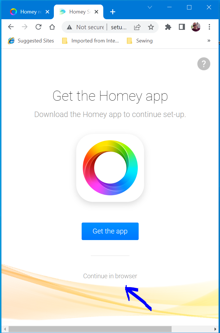

When you get to setup.athom.com, hold down the alt key and it should show continue in browser.
Then click on that.

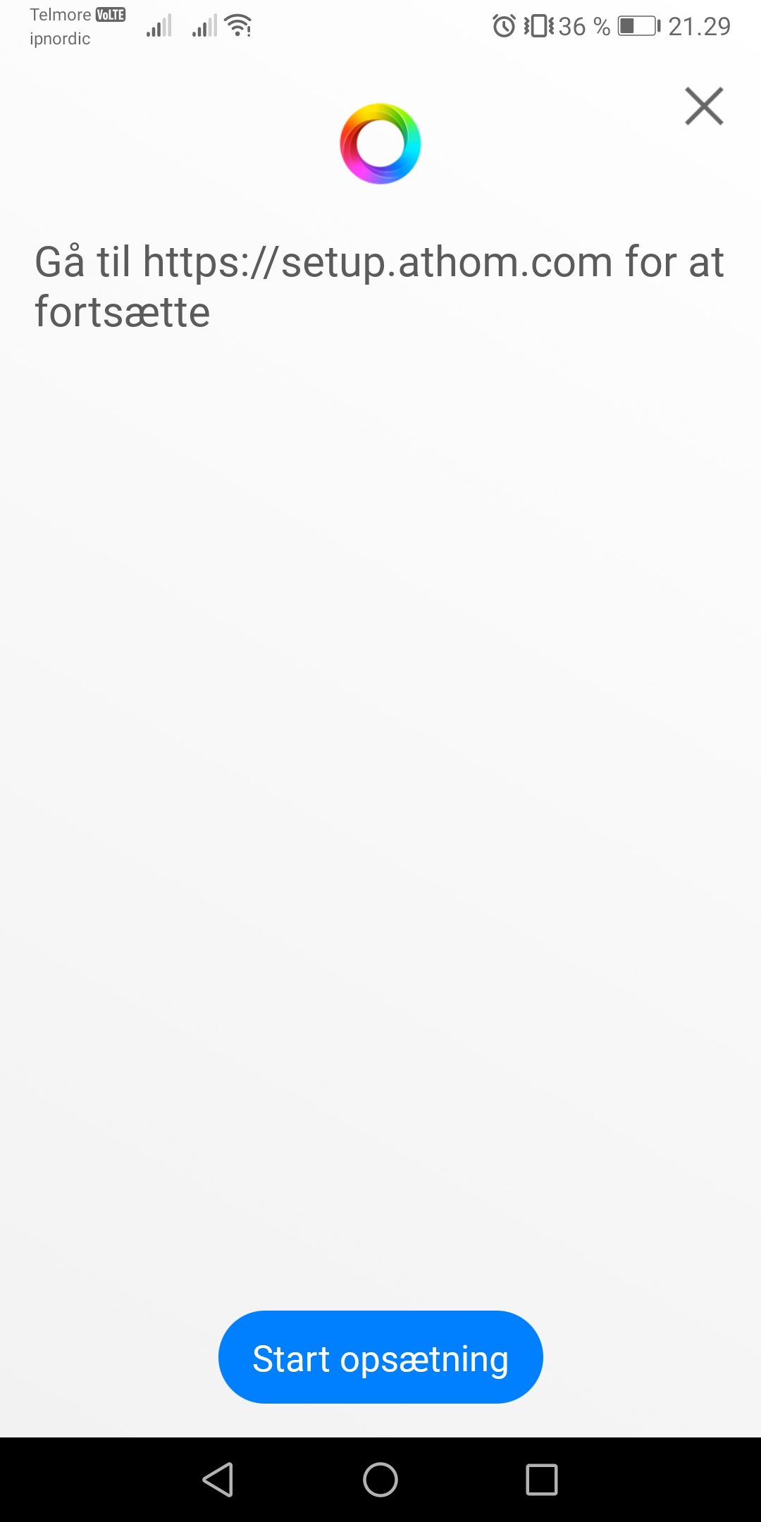

The latest app tells me to go to the website…
Pls show that screen.
Translation would be:
Go to https://setup.athom.com to continue
