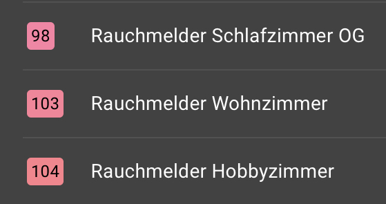

I had the same problem this week with my new Abus smoke detectors. Ok, these are battery operated, but I could find out that I had to include them extremely close (< 1 cm) to Homey. Otherwise it worked fine with a distance of 5-10 cm. For each faulty inclusion a NodeID was already assigned, but it is not visible in Developer.
Try it again with a distance of < 1 cm.

Additionally check on https://developer.athom.com/ --> Tools --> Z-Wave, if it not still included (does not show up in the app, but is still “present” in homey.) If so remove it with the menu on the right.
