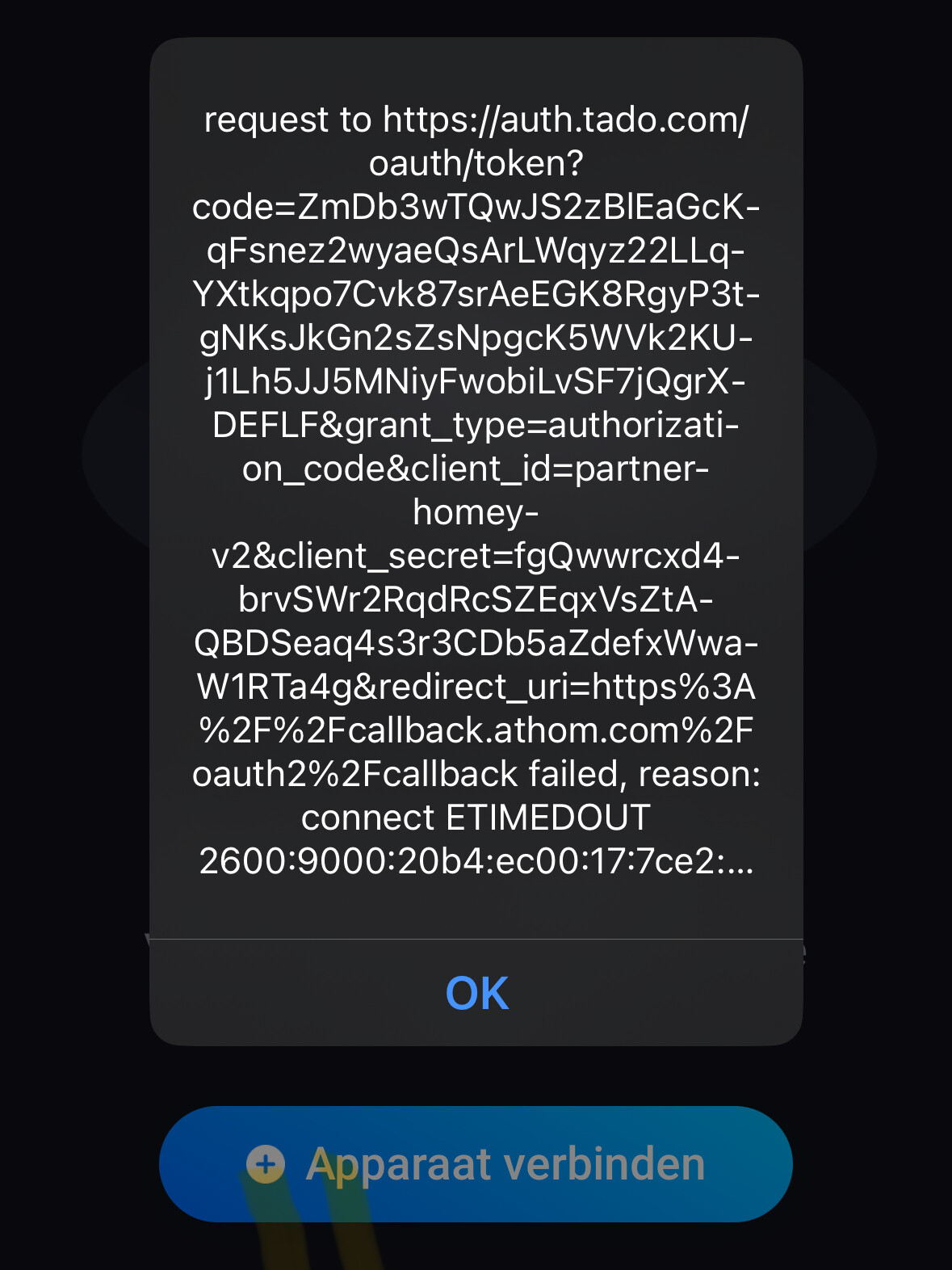

It then directs to the TADO site (auth.tado.com) where I click ok (credentials shown) and it then tells me to close window
Back in Homey app get white screen, telling me to log in to the manufacturers website (which I just did for authentication??)
Then after a while I get an error message
Any ideas what is causing this and how to resolve?

Have tried it on multiple devices: iPhone, iPad, windows laptop, all same error messages.

Yeah, that’s the big question.
The free Homey a.k.a. Homey Cloud or -Bridge is a cloud device, Homey Pro is a local network attached device, so I still can only think of a network disruption.
What just occured to me: Maybe your internet connection is connected through CGNAT. Inform with your internet provider if that’s true, and request removal of CGNAT from your connection (they have to honour that request).
(With CGNAT you share your public IP address with others, so probably the tado authentication process can’t find your Homey Pro, and the request times out because of that)
