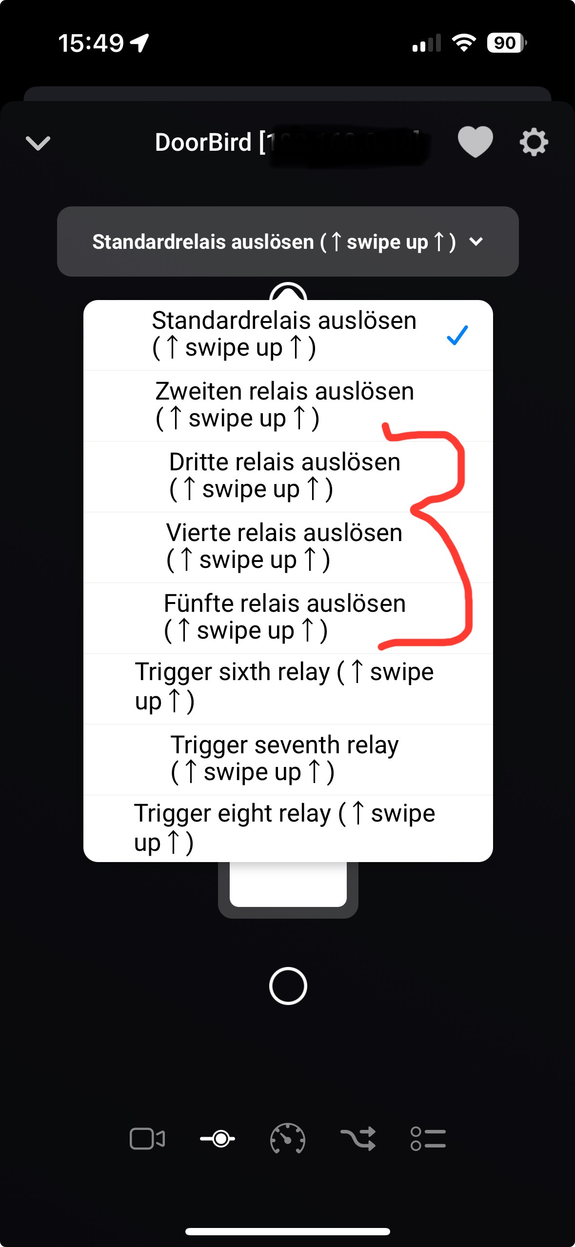

In the app it looks like this, look at the picture. The first two relays are standard in the doorbird unit (without safety).
The relays marked in red are the 3 from the controller. You can select each relay individually or of course use each one in a flow.
Thank you Asterix - this is exactly what I needed!
