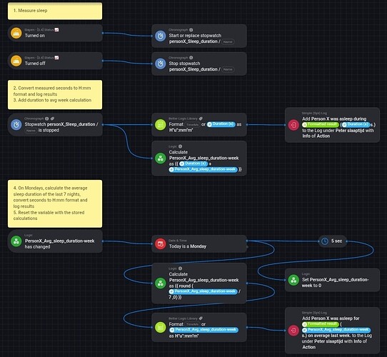

Hi community,
I want to calculate the average sleeping time of the past week with a Logic calculation. I don’t know how. I looked through topics, Google and I asked ChatGPT.
Is there any one who can point me in the right direction?
Thanks
Rogier
Hi Rogier,
This is a way to calculate it.
I use the Better Logic time formatting card to convert the counted stopwatch seconds to an H:mm format

Hi @Peter_Kawa
You are the best :clap:

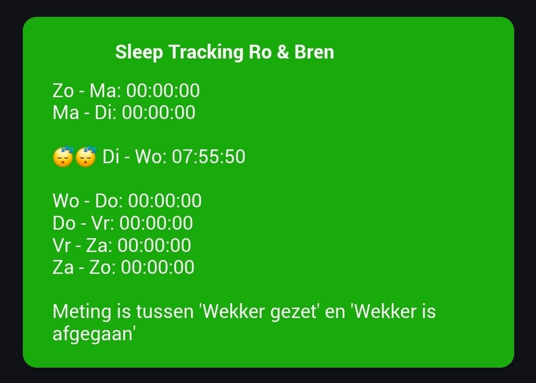

Now I have to convince my spouse to set the alarm also during the weekends :upside_down_face:
