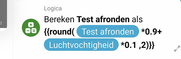

Something like this:
Where ‘Test afronden’ is your variable and where the number 2 is how many decimals you want
Okay, I think I tried it. but how can I reuse the result in another card?
The first variable ‘ Test afronden’ is your variable you can reuse. The second ‘Test afronden’ is the tag you want to round. So in this case call your first variable TempRounded and the second variable us your tag you want to round
