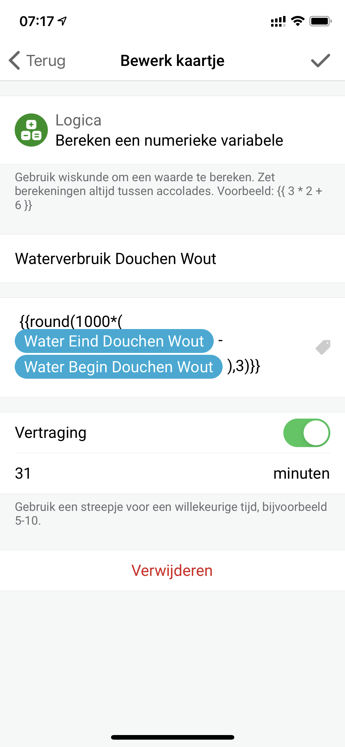

What is going wrong and right here?
The watermeter is writing its data in 486.555 Dutch. Where 555 are the liters…… thats why divided by 1000.
Round by 3 numbers behind the comma
Divided by 1000??
But… why would you want to round liters to 3 decimals. Liters is the smallest unit in case of a watermeter
So, the calculation needed looks like this: {{[tag_eind]-[tag_begin]}}
Example: 486.755−486.555=0.2
When you want the number 0.2(m³) in liter units, then all you have to do is multiply it with 1000: {{([tag_eind]-[tag_begin])*1000}}
Example: (486.755−486.555)*1000=200
