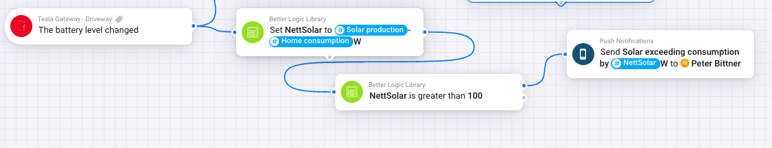

Thanks very much. So this flow should work?
And I’m assuming that if you want to see the current value of a BLL variable then the only place to do this is in the BLL App?
Edit:
No I see that it won’t. I need brackets. I tried this:
Screenshot 2023-07-09 at 4.31.15 pm
but it still looks like thats wrong as the variable is being set to 0.
Use the set expression card and remove the W at the end.
So the double brackets {{}} is correct?
No, you dont need them, they will make it a Homey calculation and the calculated vvalue will be passed to the expression card. Thats not very usefull or what you want.

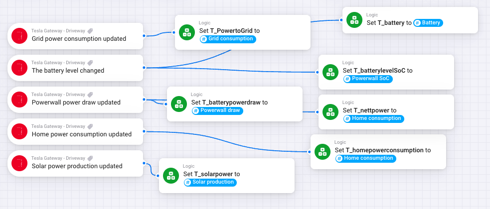

I want to set up a flow that will turn on devices (such as my car charger) once my solar panels are producing more power than needed to charge the battery or run the home. The maximum the battery will consume for charging is 5Kw, shown as -ve when charging and +ve when discharging. As electricity costs 34c/Kw from the grid and I only get 11c/Kw when exporting back to the grid then it is best to use that capacity if possible.
So I want to set up a flow so that when the Battery is being charged the maximum (-5000) and the Solar production is greater than 5000 + Home Consumption + “Some gap I can set” then turn on a device. I have included a picture of my variables and the flows I have developed to set the value of the variables. The values from the solar system update about every 4 secs.
I want to set T_nettpower to 5000 + Home Consumption + “Some gap I can set”, and then use that variable to turn on the device(s).
Screenshot 2023-08-14 at 7.08.56 am
When I get you right, you want to add the values of some tags, and a real value into a variable?
Then you need someting like this
Thanks - simple isn’t it.
I like the idea of knowing what you suggested using for the values “netto_energieverbruik” and “Power.In.Piek”. I was just going to add some overhead like 1Kw so the charger didn’t turn on and off every time there was a change in the home consumption, but you may have a better way.
