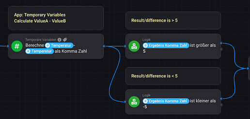

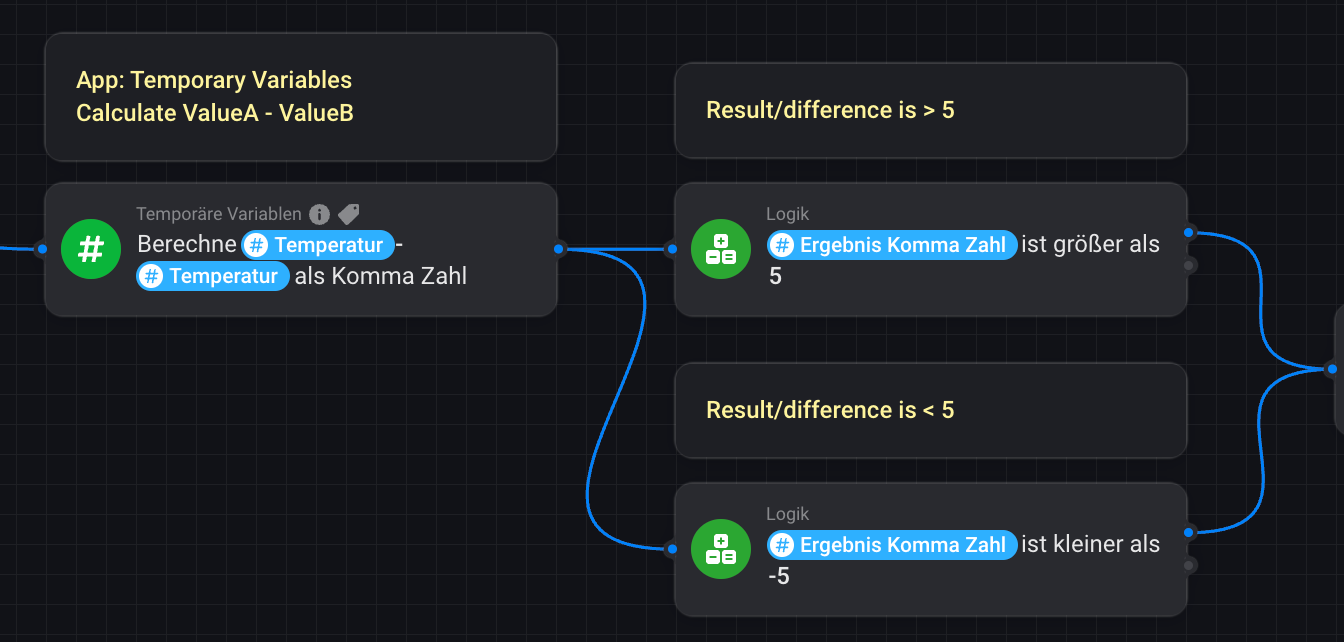

Look for logic cards. See Switch floorheating pump on Evohome trigger
Only with build-in logic flow cards:
A numeric variable is needed. Here BeispielVariable.
If you need the result only for this flow, then you can use the app Temporary Variables and build-in logic flow cards:
No numeric variable is needed.
I guess there will be also a more professional calculation way, but it works. :wink:

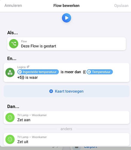

On HP2023 also with normal flow:
(Picture below has changed after some comments below)
This is not the way how it works. Or I misunderstand what @kai.wagner.83 needs.
Example
The current value/temperature of Ingestelde temperatuur is 20 °C.
The current value/temperature of Temperatuur is 24 °C.
By adding 5 °C to Ingestelde temperatuur (= 25 °C), the temperature is greater than of Temperatuur (24 °C), but the difference are just 4 °C.

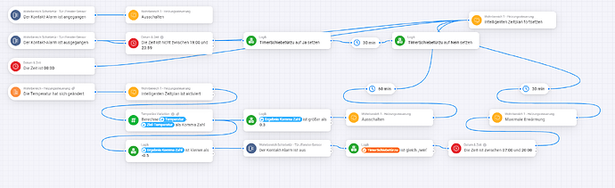

Looking like that:
What is your opinion about that?
Wow, that is much more than I expected.
I think you’re on the right road, and I am not so good in reading flows. However you might add another trigger. Because the flow below shall be triggered as well as the actual temperature has changed as well as when the set temperature has changed.

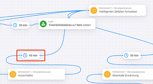

I guess it will work. The only thing I would change is to use a timer app like Chronograph instead of the build-in delays. Because:
– It’s not possible to stop or adjust the build-in delays (maybe not needed in this flow)
– The Chronograph timers will continue after a restart (for what reason ever) of Homey, the build-in delays not
I use the build-in delays just for short periods, max. 1-2 minutes. But it depends also on the background of the flow, e.g. watering of the plants.
Example in your flow, if Homey “dies” after Ausschalten, the heating will be turned off until one of the other flows set the heating again to Intelligenten Zeitplan fortsetzen, because the 60 min. build-in delay will be interrupted:

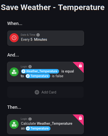

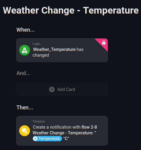

You can do this for example:
First create a text variable, I called it
‘Weather temperature’
Screenshot from 2024-04-28 04-43-33
The blue [Temperature] tag in the cards it’s in, is from Homey ‘onboard’ weather, you can select it like this:
Inside the (timeline) card, click the ‘tag’ icon on the right hand side
Then you can pick the Temperature tag:
Screenshot from 2024-04-28 04-49-57
