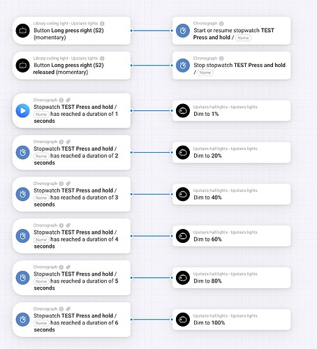

So basically my flows look something like this:
So basically the red part needs to be removed to make place for the thing I want to achieve:
On liong press Dimming the smart lights up in tranches and on another long press dimming them down in tranches.

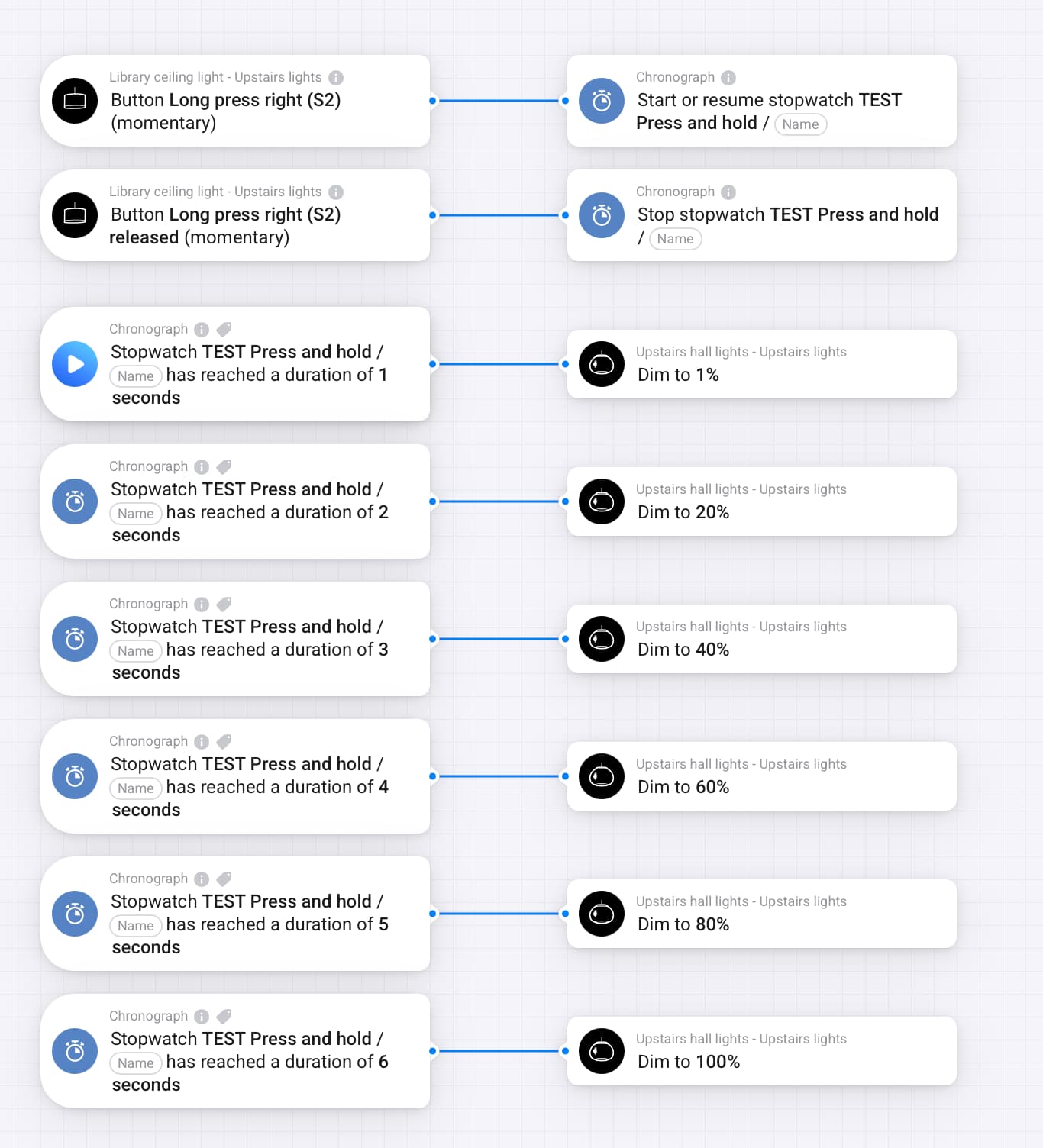

I think you need something like this to replace the red part. You will need to install the Chronograph app from the Homey App Store. This starts a stop watch when you long press the button. The stop watch is stopped when you release the button from a long press, so that the lights stay at whatever dim level they reached when you release the button. Every extra second the stopwatch is running, the lights are dimmed to the next level.
EDIT: Actually, that should work for dimming up but not for the dimming back down again part. Let me have another think.
OK here you go. This should now do both up and down. Using the transition feature of the Chronograph app this time. You can adjust the speed at which the lights move between the steps by changing the duration of the two transition timers from 3s to whatever you want. This is the total time taken to get from the first to the last step if you keep holding the button.
Note that this doesn’t actually give you fixed size ‘steps’. It actually divides the total gap between whatever the current dim state is and the target one (either 100% or 0% depending if you’re dimming up or down) into 5 steps over 3s. You can adjust the number of steps as well if you want to go more smoothly. I tested this on one of my lights and I think the effect is quite nice.
Hey This is quite smart. Ill try to emulate on my side. the first example is easy to understand, its the dimming back down that I dont fully understand…so lets try that by actually building it. Thanks in any case for doing this, this is great! :slight_smile:
Happy to help if you get stuck implementing it.
