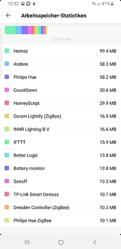

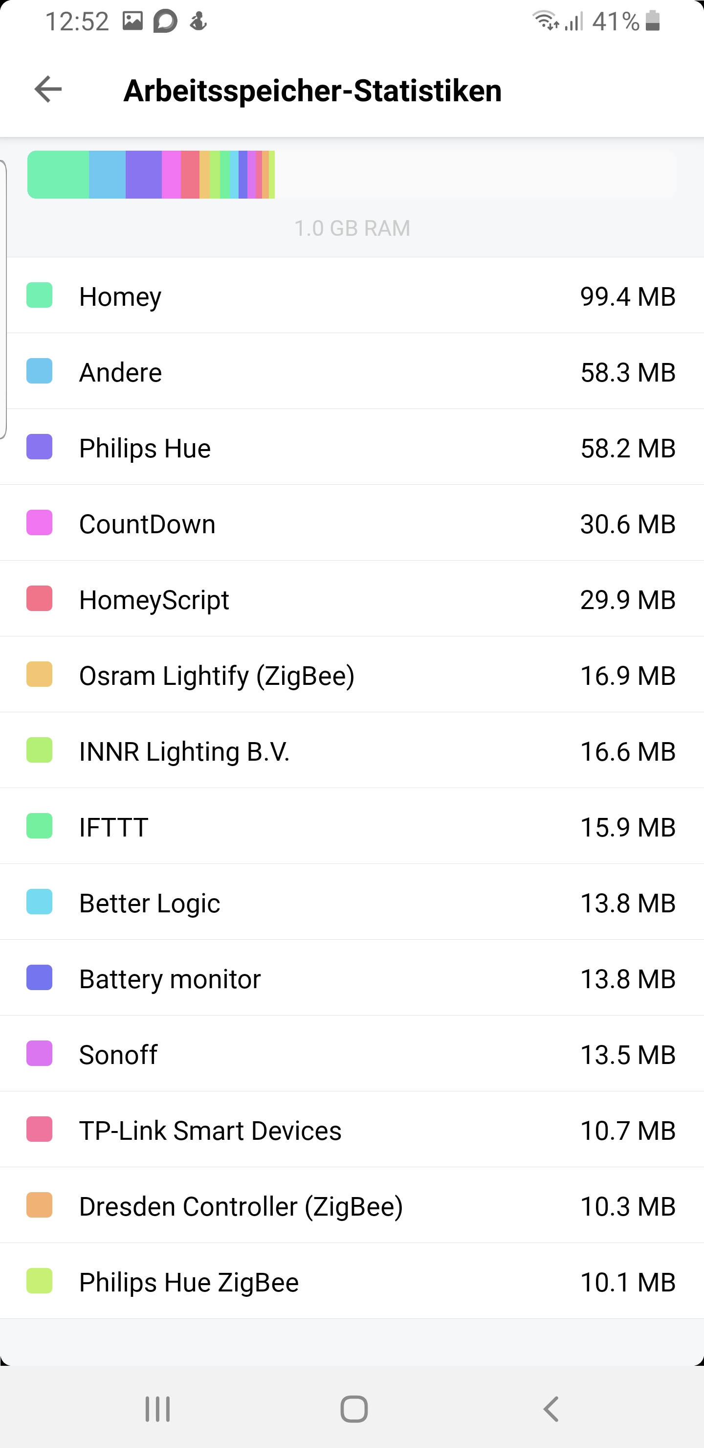

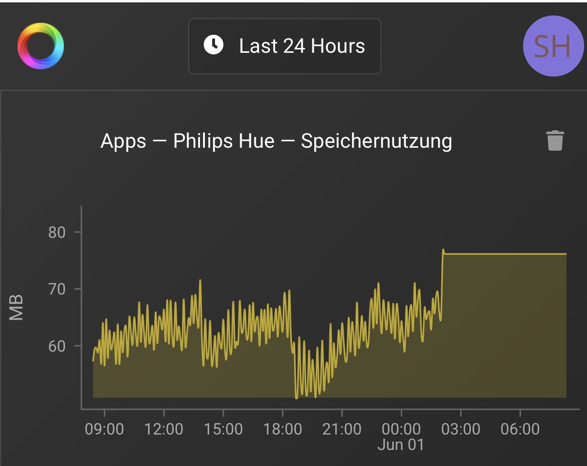

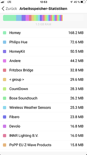

@adem_p What is the memory usage after 17 hours?
After switch from beta to stable, I had also a uptime of more than 24 h!
