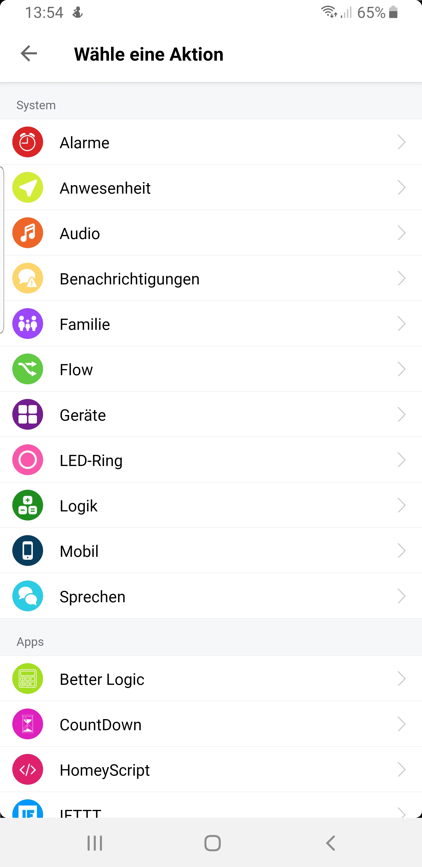

Make a Flows which restart the Philips Hue App every 2 hours.
Unfortunately it’s a knowing issue without a solution so far. I have also the same problem.
k thx, and how :)?
via homeyscript
await Homey.apps.restartApp({id: ‘magic.home.wifi’});
await Homey.apps.restartApp({id: ‘com.swttt.homekit’});
await Homey.apps.restartApp({id: ‘nl.scanno.mqtt’});
return true;
Per Flow:
I don’t have that, is it an app?
