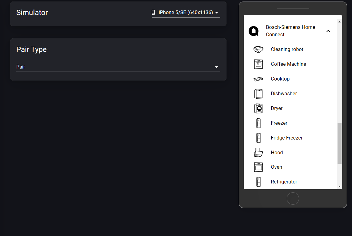

Solved the problem. Just had the idea to do the pairing process in the Homey developer interface. Worked without problems.
The developer of the Bosch-Siemens HomeConnect app should have a look at this. Apparently the browser login command is called in a wrong way on Android, at least for some configurations. Since I tried with several mobile devices (Samsung S7, Samsung A5, Huawei), the mobile is not the cause. It must be the way my Homey is configured (not that I did anything special with it, but I have similar recurring problems with the Alexa app that only few people seem to experience).

Thank you, it worked finally via the developer interface. You reported this back in 2021 :anguished:
Thanks, I had the same issue with my Siemens appliances finaly could add all 8 devices. So the issue still remains now it’s 2024…
tried to add it through the devloper interface, but no luck":
any tips from others?
solved it. you need to activate remote mode in the connect app (on android or iPhone) after adding it to the app there. after that add it through the dev as mentioned above
