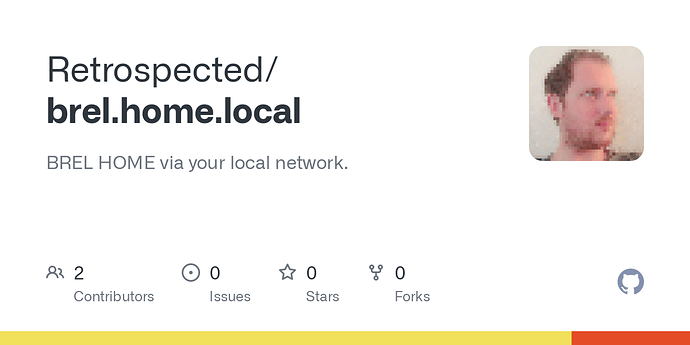

I also created a app that uses the Brel Home Hub via the local network and doesn’t require the cloud back-end, to control the blinds. You first have to pair them via the Brel Home app though.
It currently only supports bidirectional roller blinds, because those are the only ones i can test.
I did not push it to the Homey app store yet, but let me know what you think

Really nice that this connects directly via the internal network.
Adding those blinds in my app shouldnt be that difficult… the problem is that i cant test how those messages look like that have to be send to the hub directly.
I can try to implement it blindly, but it would be nice if someone can test it for me.

Yes, I was able to install your app on the Homey this morning. I am also connected to the brel hub. Happy to help with testing, I have the BJE24E TDBU motor and DD7002-B wifi hub.
I’ve made a start and figured out the requests towards the HUB to support it, based on similar opensource applications.
