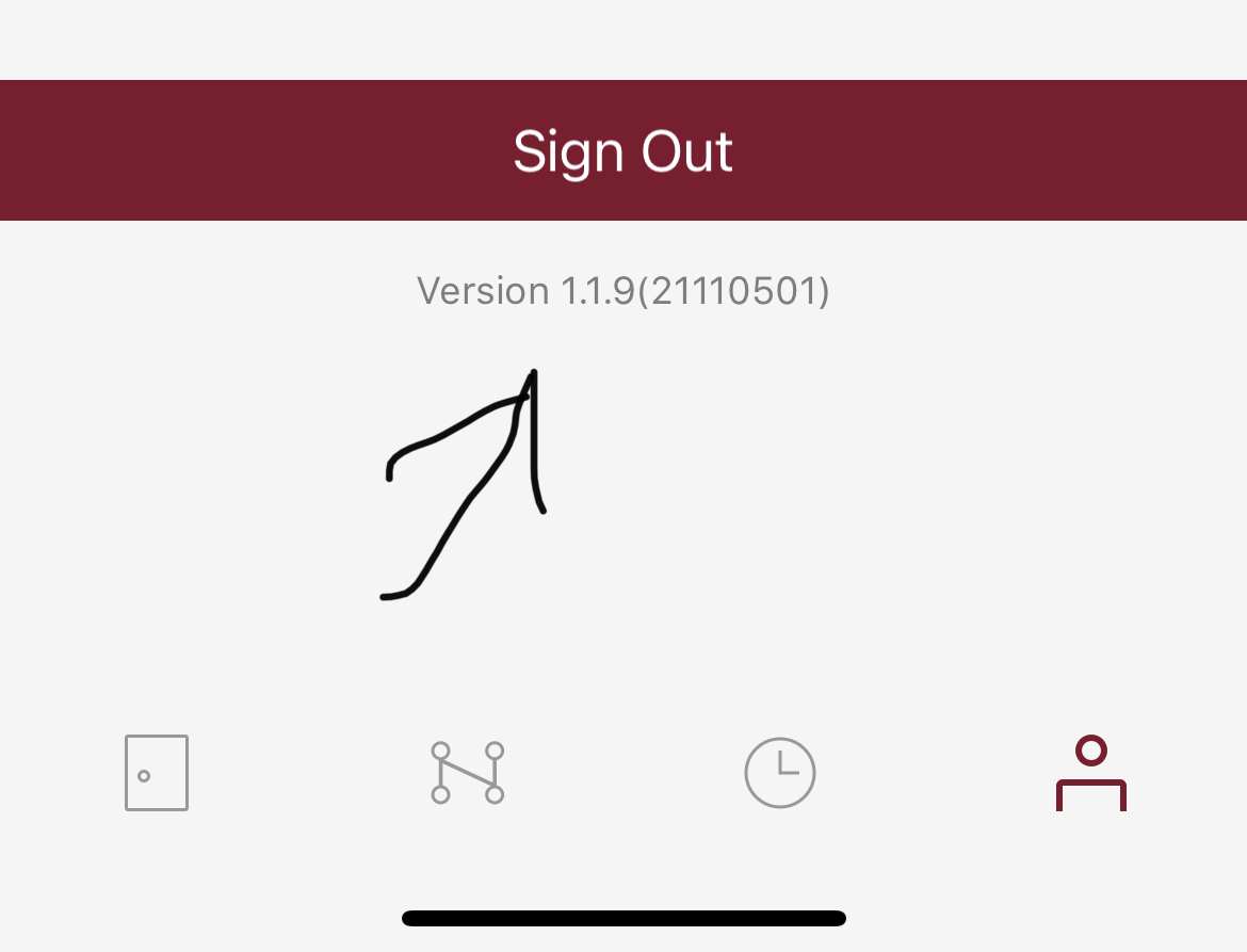

For the AccessToken you need to open the BREL HOME app. Go to the account setting (right bottom).
Then click 5 times on the version (below Sign Out) and it will show the token. Copy it and past it in the Motion app settings in Homey.

I tried that already and just tried it again, even on an other phone, but that doesn’t work…
This is the version number in the Brel app. Does multiple times clicking not work?
This is the Android version… I clicked it many times, but no luck

The key is retreived from the android app (Thanks to Brel support).
Tap 5 times on the rightside of the photo place (4th tab).
This also works for iPhone. Same menu.
That’s it! Thanks!
