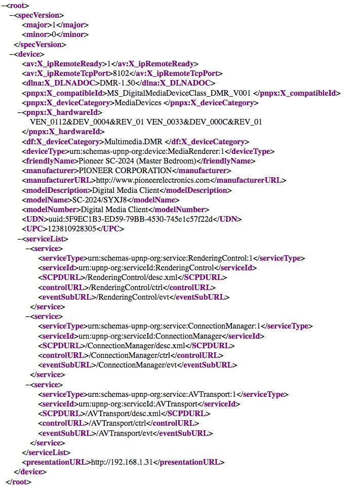

Firefox reports this from 192.168.1.31:8080/description.xml: (Chrome/Safari give errors)
1 0 1 8102 DMR-1.50 MS_DigitalMediaDeviceClass_DMR_V001 MediaDevices VEN_0112&DEV_0004&REV_01 VEN_0033&DEV_000C&REV_01 Multimedia.DMR urn:schemas-upnp-org:device:MediaRenderer:1 Pioneer SC-2024 (Master Bedroom) PIONEER CORPORATION http://www.pioneerelectronics.com Digital Media Client SC-2024/SYXJ8 Digital Media Client uuid:5F9EC1B3-ED59-79BB-4530-745e1c57f22d 123810928305 urn:schemas-upnp-org:service:RenderingControl:1 urn:upnp-org:serviceId:RenderingControl /RenderingControl/desc.xml /RenderingControl/ctrl /RenderingControl/evt urn:schemas-upnp-org:service:ConnectionManager:1 urn:upnp-org:serviceId:ConnectionManager /ConnectionManager/desc.xml /ConnectionManager/ctrl /ConnectionManager/evt urn:schemas-upnp-org:service:AVTransport:1 urn:upnp-org:serviceId:AVTransport /AVTransport/desc.xml /AVTransport/ctrl /AVTransport/evt http://192.168.1.31@Ruskie many thanks for trying the app. Not sure why the app went white.

- can you run the description command again from another browser like IE or Firefox otherwise it Will give the error instead of the real page.

@Ruskie was the output on the browser looking like this.
Because i think it is reformatted by the forum like Dennis wrote.
@dENNtoet i Will try to reproduce this.
Yes, I copypasted the output and it ate up all LF/CRs
