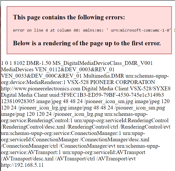

In the mean while, could you share a screenshot of the results of the following url: https://your_device_ip:8080/description.xml
Then I can make sure your device is compatible as well.
Not sure if this is what you are looking for…
On HTTPS I get a page not found.
On HTTP:
Thanks.
So here is the problem, your device is a VSX-528. Apparently this page differs from my VSX-921. I have to look whether the current design can be adapted to support SSDP for your device. Otherwise, I have to make another driver that scans the network using the MAC adress or a driver where you can mannually insert the IP and Port settings. Because normaly I could read that from that page.

Is it possible that you used Chrome for the http://IP:8080/description.xml?
Because i get the same error with my device using Chrome but the correct information when using Firefox or IE. Can you try that for me?
On Firefox I get this back… I couldn’t paste in the code, the site reformats it to just plain text… so I just screenshotted it.
Is this what you are looking for?
Yes! That’s it. Looks like it is compatible after all. I changed the volume slider functionality to use a sequence of VD or VU it works on my device. So should work on yours to.
