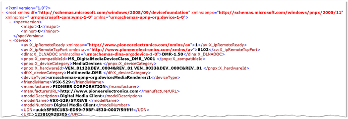

I could telnet to 192.168.5.11 8102
With the command PO to turn it on
From my laptop
Hi there,
I tried the test-version v0.1.3 with my VSX-529 and get a device not found message.
From another project I know that port 8102 is working:
Via HA Bridge
Please let me know if I can help/support somehow.

Thank you for the feedback and the screenshots! It helps a big deal to splice the issue. I think I know what the problem is for your device. If possible I will post a new test version here tomorrow.
