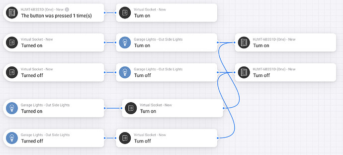

So this is my approach to to control the lights, does it make sense? is there a better way more reliable (for whole home, more than 30 relays)?
Here are the when cards in the flows.

I have no clue why that would be a better approach. So I would go with flows.
