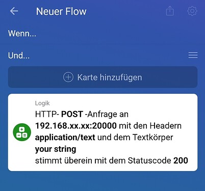

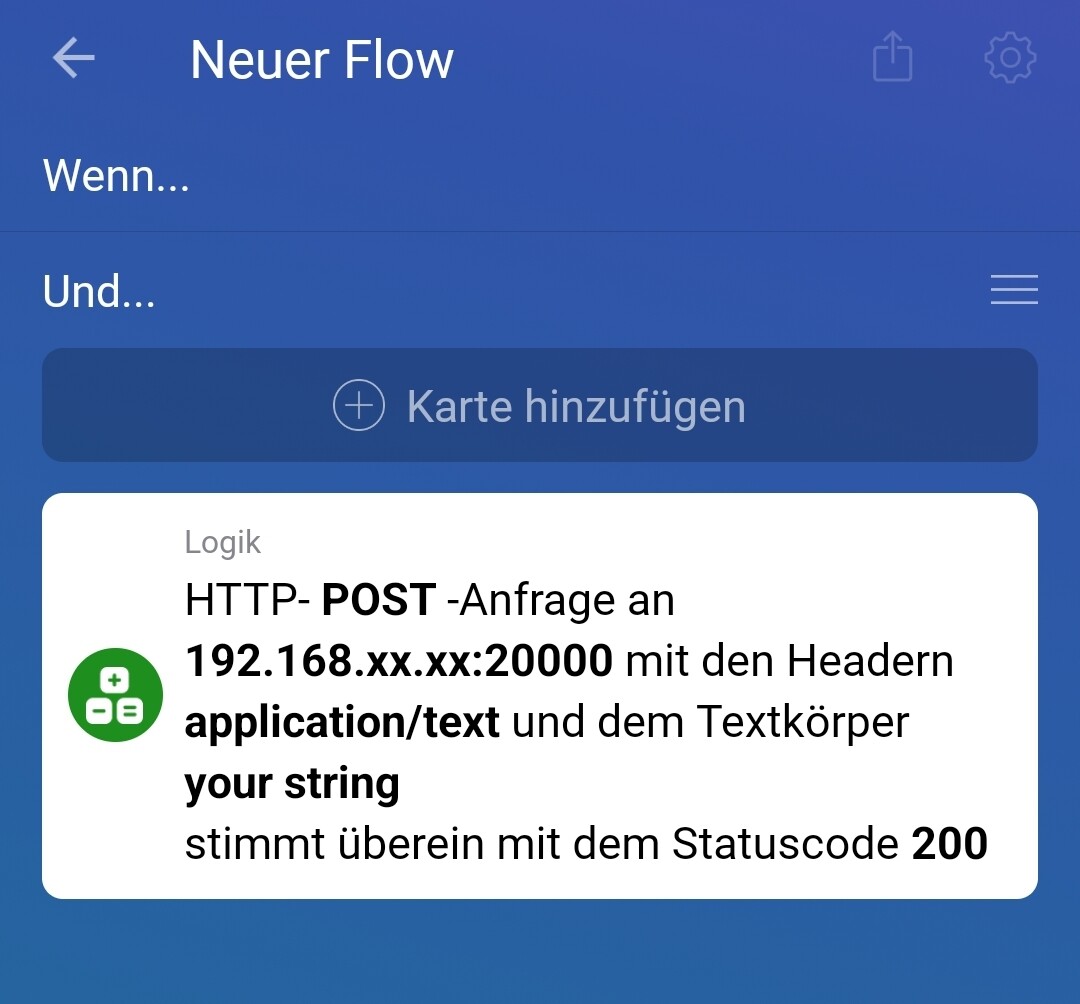

You could use the http logic card as condition.
You can define the thhp type (post), IP:Port and the http body.
It http post right? Is application/text right?
You can define a http code for the condition.
So if http returncode= 200 (ok), your flow will continue with THEN part.
If the server is not responding with http codes and you need the result body, you can take a look at the “Http request flow cards” app

Hello RonnyW,
thanks for the answer, I tested and I get an error
Any idea ?
