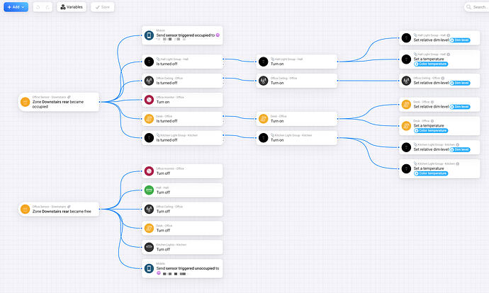

There are two main flows:
  1. Presence flow (Aqara FP2)
    • Triggered when a zone becomes occupied / free
    • Turns lights on only if they are currently off
    • Applies Circadian values brightness and colour temperature immediately after turning them on
    • Turns lights off again when the zone becomes free
  1. Circadian flow
    • Triggered by “Circadian values changed”
    • Periodically re-applies brightness and colour temperature
    • Uses conditions like “light is turned on” to avoid touching lights that are off
I’ve added notification cards to both flows to see exactly when they fire.

I noticed that you are using ‘set relative dim-level to ..’
What happens when you use the dutch ‘dim naar ..’ (Eng:dim to ..?)card?
You also may try to dim to 0% before turning the lights off.
While the dimlevel is 0% you can have the circadian app change the colortemperature invisibly.
And when the zone becomes active don’t turn on the lights but use only ‘dim to #dimlevel’. The colortemperature is already set.
Thanks for the suggestions, very helpful. I have applied the changes and will see how it goes, initially I was getting lights reverting to defaults but at the moment it appears to be working. I’ll let it run through some cycles and see if settles down. During testing I did see anomalies like not all lights being turned on or off but working if I ran the test again. I guess my expectation was that with Homey Pro and the Homey software automations would be more reliable but I suppose its all the different manufactures maybe being less reliable, trying to automate so many lights in one go as well could be problematic.
