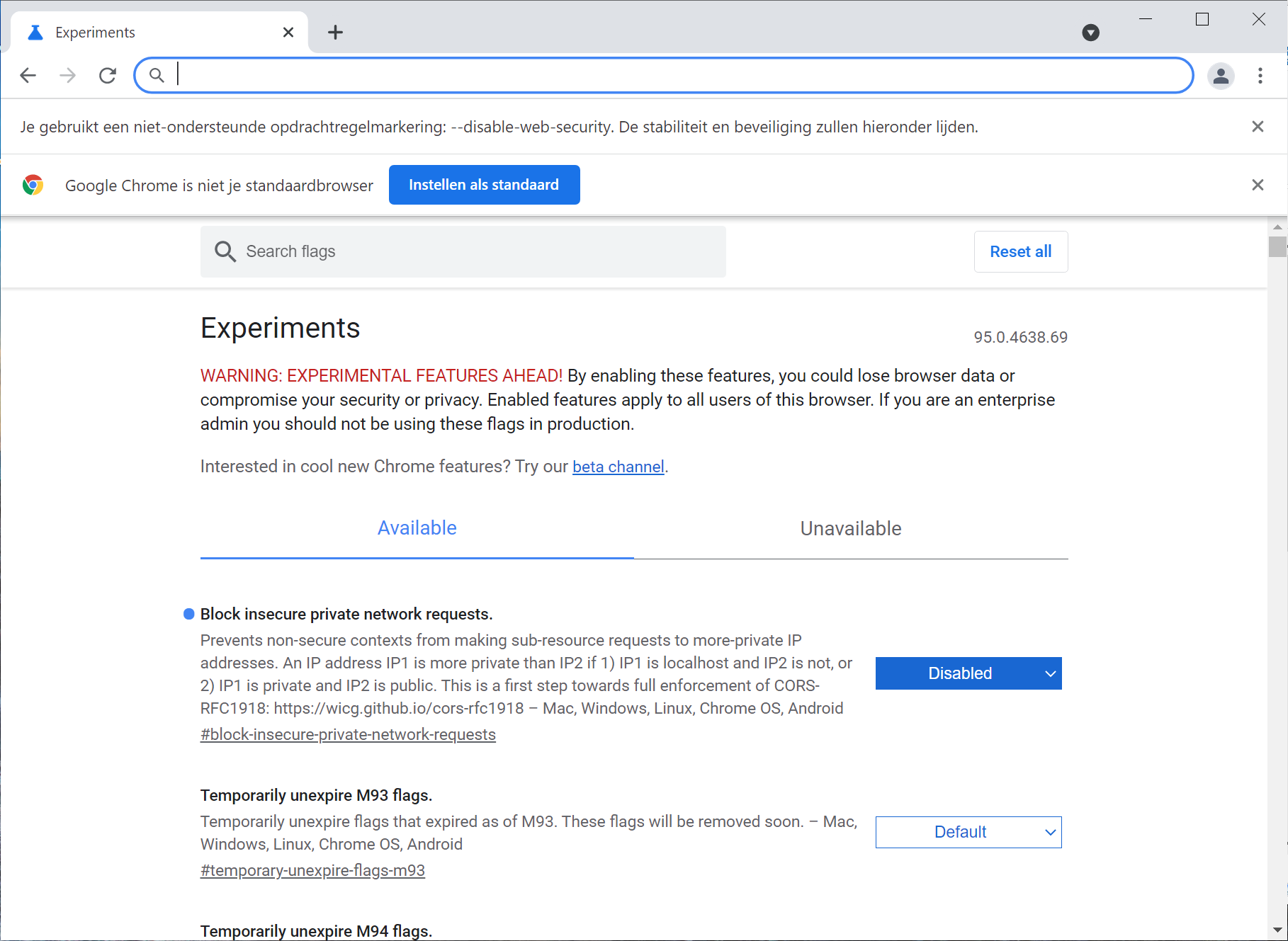

  1. Alter chrome flags: Set “Block insecure private network requests” to “disabled”
    a. Type within chrome bar: chrome://flags/
    b. Next look for “Block insecure private network requests” and set this to “disabled”
    c. restart browser
    (See: answer of android - Chrome future update Restrict "private network requests". Will it affect scanning hardware on devices that make local connections? - Stack Overflow)
