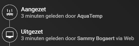

I tried the app (instead of Home Assistant as it suddenly stopped working).
Seems to work fine & i can turn off/on etc, but every setting i do seems to be reverted after a couple of seconds by the “AquaTemp” app (that’s how it shows in the timeline).
Logs: 8653691c-9060-4ba5-b148-2cd87a6f4b8a
See below, the heatpump was switched on (it was already running). I switched it off using homey, and after a couple of seconds it reverted back to the “On” state.
I see the same. But using the officiel aqua temp does the same. It is like updated values are never actually sent to the heatpump.
I believe this is some kind of generel server error and not something I can do much about.
But it is really annoying. I hope it will gets fixed soon.
This should be an easy fix.
Ah, didn’t test using the official app. Probably a server ertor on their end. Will have to wait for them to fix.
