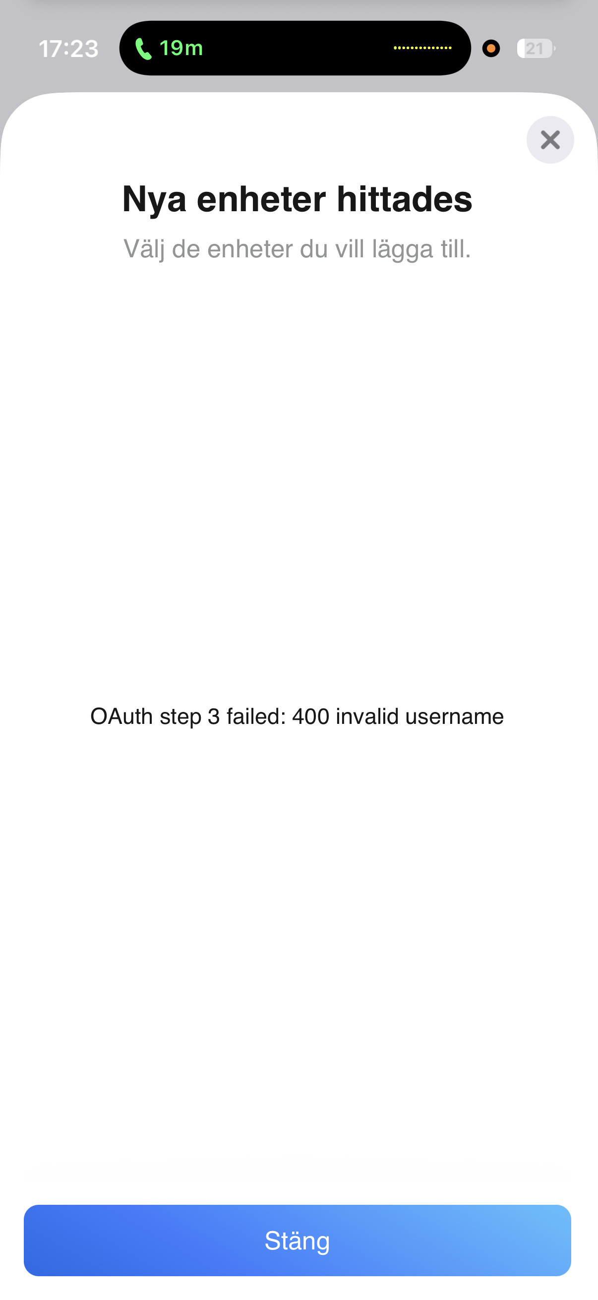

If I try to install a new device, I get the following error:

  4. Add new device with previous login information and get the same error.
HOWEVER, if I try to add a new device with with my standard account (I have been using an other account for homey app) it works to add a new device.
Does it mather if I use same account as I use in the android Panasonic Comfort app?
you need to use the same account everywhere,
