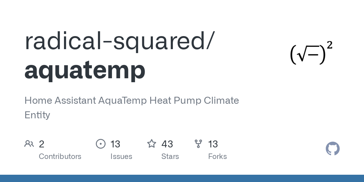

I know that this HA integration works. Might be able to get som ideas what needs to be corrected.
