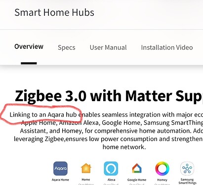

Yes. It"s also clearly stated in the first sentence of the product page
Meaning, Aqara is fooling you a bit when you don’t read the small prints;
The outlet is only available as Matter device to Homey if paired with the Aqara Hub

Thank you @Peter_Kawa for your feedback. Small prints are important in domotic, you are completely right!
