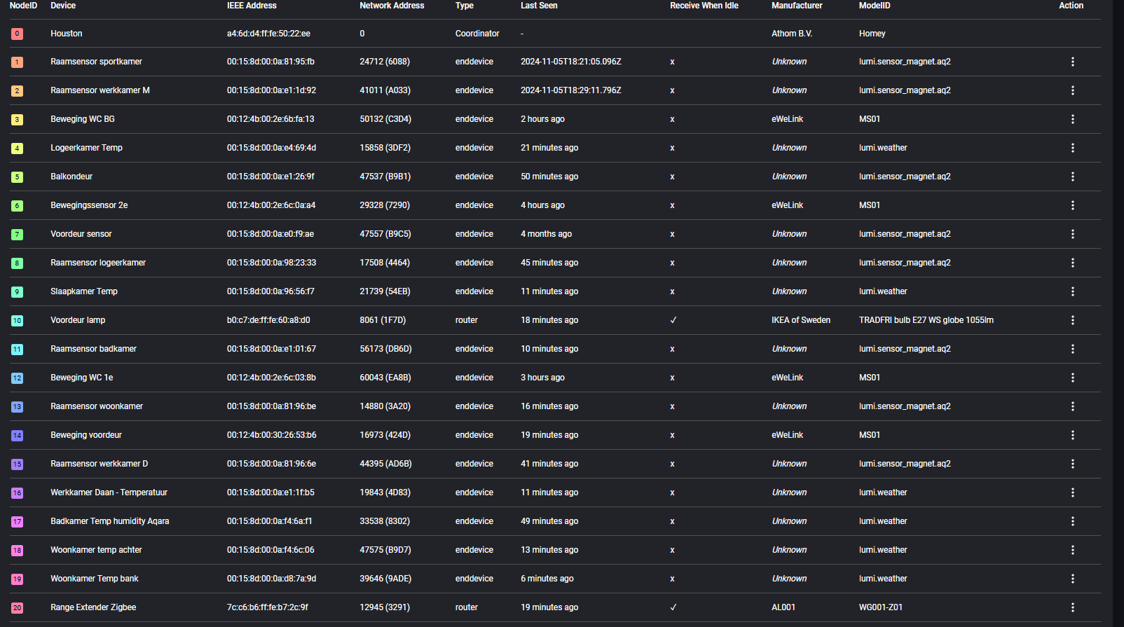

These are all my current zigbee devices. I just received the repeater (last one on the list) and plugged it in. Not sure why none of the devices appear to route through the routers.

We don’t see the routing paths unfortunately, if you are speaking about them, I assume you have HP19. On the list I see one router - lamp - do you cut the power from that lamp ? If so, stop doing it. When you turn the lamp off or of the lamp is on but childs ignore it in the routing path, then you run over the limit of max paired Zigbee devices (childs - battery operated, the limit is 15). The router, you have added, unfortunately will be ignored by the devices, that’s why routers must be included first and then battery operated devices.
Please check https://support.homey.app/hc/en-us/articles/360019239879-Creating-a-stable-Zigbee-network-with-Homey-Pro
You can however try workaround, after you added router, try to re-add those devices without removing them. It will complain that device exists already but will get awaken/fixed routing.
Then check the routing paths… try first with nodes 1-10 to see if situation will stabilize.
Best would be to do the reset and then add routers and then battery powered devices…
Btw, I hope you have already Zigbee network after reset, eg. you don’t have common network key anymore. If so, that would be another reason for full reset (but all your flows will get broken, so it’s painful process even with the script available here)

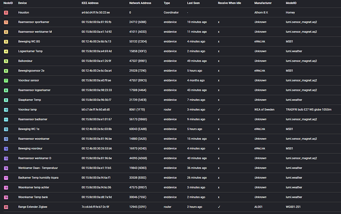

I tried re-adding one of the temperature sensors (number 19) which is positioned next to the new extender. Unfortunately nothing changes in the node list:
I also tried re-adding the number 19 device. It’s now number 20, but still can’t see it being connected through the router. What am I doing wrong?

On HP23 you will not see any changes or routing paths - just watch the Last Seen, if it keeps updating (Eg. 1 time per 1 hour at least but it’s device specific)

Thanks! It does seem to sync more regularly now, so that’s great!
I was hoping Zigbee would show the routing in the same way as Z-Wave is shown in the developer tools (eg 1 - 5, 1 - 4, etc.).
This means you can’t see if the range extender is actually used :stuck_out_tongue: Interestingly enough: the range extender is now the only one which was last seen almost 24 hours ago. While all others were seen <1 hour ago…
