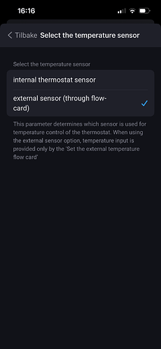

The Homey Brigde are connected to the Aqara smart radiator termostat and Aqara temperature sensor. In the setting for the smart radiator termostat i set the device to use an external sensor and make a flow to connect these device
And the flow
Yeah that should work correctly with that setting and flowcard, Morten.

@Morten, the setting worked fine …. for a while. stupid question … you saved that change after you put external sensor ? ;D

i did this already several times via official aqara seite, PN the dev , here in the forum,…. n-o-b-o-d-y cares ….. seems like …. it worked for a while and then for no reaseon in reverts back to internal but configuration stays at external temp sensor …. giving an error message when flowcard will set exytternal temp that it cannot be set becauise the thermostate is set to internal which is not true … so i have to redo ALL temp configurations back to internal → SAVE go back and set to external → save … and then it works for days, weeks month till next reset ….
