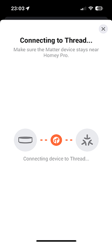

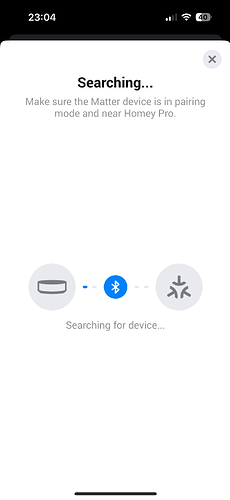

I bought 20+ aqara led T2 bulbs, I can’t add them to Homey Pro with matter over thread , I’ve probably tried all possible ways, multiple times.
While trying to add, bulbs and homey pro are within a meter.
The bulbs are ok, I can add them to the aqara m3 hub and to the smartthings hub, but not to Homey Pro. I’m attaching a screenshots

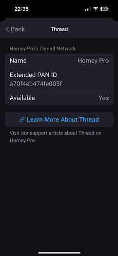

. In the last screenshot it is visible there is a thread network called ST-TIZEN and that it is not available? based on the name I would say that this homey took something from smartthing? how, why? Please help!

What exactly aren’t they doing correct, then? There seems to be something wrong with Homey’s Thread network, as it seems to be pointing to another Thread network, which shouldn’t even be possible.
@susniand are the devices still paired with the Aqara and/or the Smartthings hubs? If so, you cannot use the Matter pairing code on the device. Instead, you need to use the Aqara or Smartthings apps (their official apps, not their Homey app) to create a new pairing code that you need to use for Homey.

Im trying to connect via Homey Pro and not via iOS.
Same result if I do it with Homey app or Web app.
@robertklep video clip shows brand new Aqara led T2 bulbs, directly out of the box. Also tried to factory reset it (10x on/off)
Yes, brand new devices.
I have other bulbs connected to Aqara hub via thread and I can share them (via matter qr code generated in Aqara app) to Apple home, Smartthings and Homey.
I just want them to be connected directly to Homeys thread network as i dont want to have multiple tiny thread networks.

No luck, thread network is still here and cant connect anything to it. (see screenshot)

It says “Homey Pro’s Thread Network”:
But the article you refer to also states that Athom implemented their own Thread commissioning, and that’s what’s failing.
