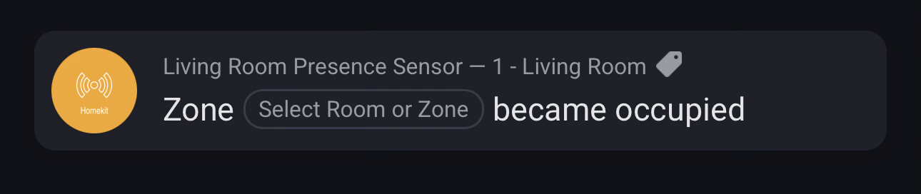

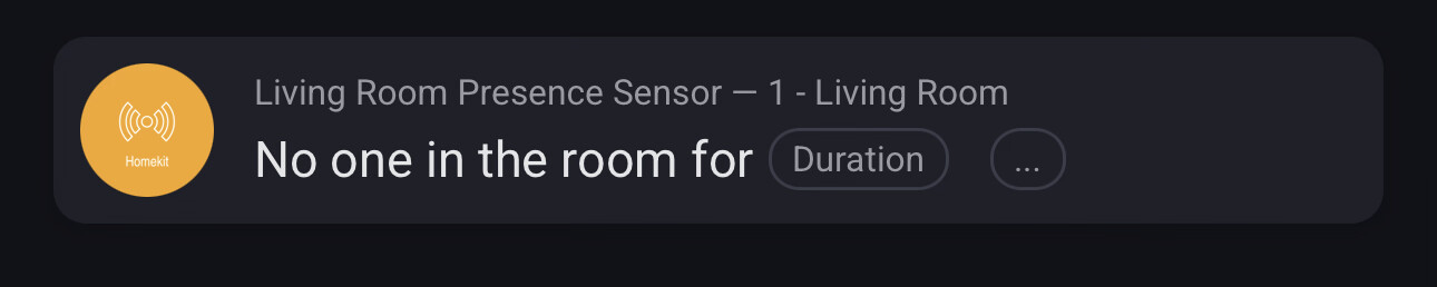

Yes, try using the “Zone ??? became occupied” and the “No one in the room for ???” When cards in your advanced flow. That is what I use with my FP2 and they work great 99% of the time (I added And no motion for N minutes condition too, to fix that 1% outlying case)
