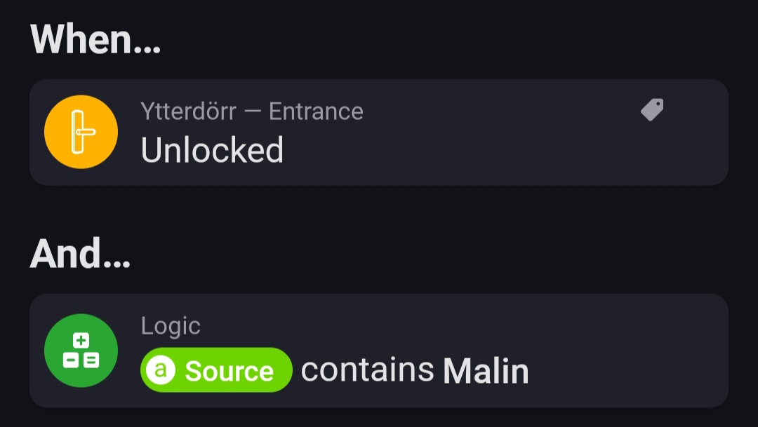

Can the Yale app trigger flows based on who unlocks the door? For example if the cleaner opens the it turns on all the lights? They have their own code in Doorman L3. When i create the flow I cant select a user but it is shown only as a tag or something
Yes, use the source tag in the And card “if source contains cleaner” or similar.
Hi, sorry if this is stupid question but there is no such card? Below capture from Yale App “and cards”

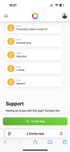

I’ve just bought a new smart lock, Yale Linus L2, together with the Smart Keypad 2. The keypad offers the option to ring the bell, but there is no condition for “when the bell is ringing” in the Yale app. Do you have any idea how I can play a sound on my Sonos speakers when someone presses the ring button on my Yale Keypad 2?
Thanks in advance for your help.
Which app is supporting the Yale Smart Keypad 2?
I thought that Yale Home should as it is stated on official website. But seems like currently it is not possible. And I do not know about any other app.
Yes, now I found the card.
To make sure the WHEN card does not trigger, add a time line card direct after the WHEN card.
In that case, contact the developer.
I don’t get your answer to be honest. My issue is, that I would like to have that specific WHEN card, but I do not see it.
So the app’s description states is is there,but you don’t see it when you make a flow?
Yeah, that’s exactly the issue.
I am in touch with developer already and they will investigate it. Currently it seems like it is not supported yet as it is quite new device.
