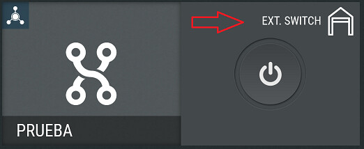

Hello @Phuturist, I’m testing the add-on. I can see the temperature of the thermometer without problems in the app, but if I connect a reed-switch it does not appear in the app. It is apparently not supported.
I leave you some pictures. This option is very useful to know for example if the gate is open or closed from the same shelly 1 that you use to control it. This is done by connecting the reed-switch between the black and yellow wire of the add-on.

This is the option in the shelly app:

Which version of the app are you using? If it’s 3.x, are you not seeying the input alarm being changed when the reed switch is changed? If not, could you post me two examples of the output http://yourshellyip/status, one where the reed switch contact alarm is on and the other where it’s off. If you are still on 1.x, then yes it’s not supported yet.

I believe what @Eduardo_Rodriguez wants to accomplish is something like what is possible now on the shelly app itself, with the use of the add-on connected to a reed switch the app can tell you if the gate is open or closed (in the case of the shelly being connected to a gate), like it’s shown on those pictures sent before by Eduardo , and if this could be also done with your shelly app something like when the gate is open have that little “:warning:” mark on the button, and when it’s closed that would go away , something just like a motion sensor…
I imagine this is what Eduardo wants, and it would be kind of cool if we could visualize on the button the state of the gate.
I know all things related with flows can be accomplished right now with the Input state identifier, it’s just more of a visual thing i imagine.
Ok, thanks for clearifying. The answer is that it’s not possible to select what is show on a device card. What is shown there is based on the default device class and capabilities which in the case of a Shelly 1(PM/L) is a socket with no special capabilities. I have no control over this but is part of Homey core. @Eduardo_Rodriguez
