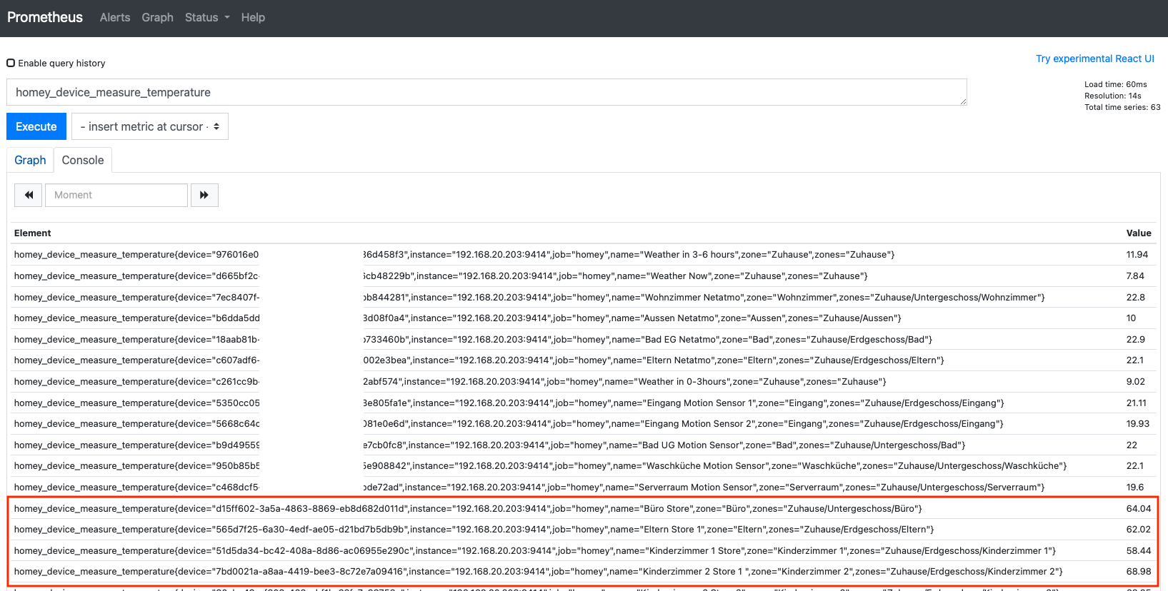

I’m storing the shelly temperatures with prometheus (Homey App) & display them with Grafana. I have multiple devices which are reporting a temperature, eg. a weather station from netatmo or a temperature sensor from Gardena. The shelly app also reports a temperature, but the temperature is from the the device internally, which isn’t important for everyday use and doesn’t reflect a room temperature. The problem is, that the key/name of the value is “homey_device_measure_temperature” and will be used as well for my netatmo weather station or for my gardena sensor, so at the end I’ve to specify every single device instead of getting all “homey_device_measure_temperature” values to get rid of the shelly devices.
So long story short, in my point of view it would make sense to rename the temperature for the shelly eg. to “homey_device_measure_temperature_internal”.
In my screenshot you can see as well a real temp sensor key “homey_device_measure_temperature_1” for a temp sensor which is connected to a shelly 1, that makes sense.
I don’t know where prometheus gets it’s key from, but I’m guessing it’s derived somehow from the shelly app code. In the prometheus app I can’t configure anything.
Hope this makes sense. @Phuturist what do you think?
Although I understand your issue I wont be changing it. Using a default capability instead of a custom renamed one is much easier to maintain as the flow cards are auto generated for default capabilities. And some people actually depend on this default capability for other integrations which would break when changing it to a custom one. Next to that your situation is a corner case which will not benefit much users anyway.

I haven’t used Prometheus in a while, but can’t you create a query that would exclude Shelly devices?
homey_device_measure_temperature{name!~"^Shelly"}
That way, you can give all your Shelly devices a common (unique) identifier in their name to use as a filter in Grafana.
Ok got it. Some other app devs have done exactly what I suggested (gardena with the sensor eg.), but I fully understand your point. It’s truly corner case.
Good Point, I could do that, but the name of the device would get even bigger than it is today.
My device name follows this schema today: (Room Name) (Device Name)
The bad thing here in my eyes is, you can create zones/rooms to split up everything, but if you create flows you don’t see the zone/rooms but just the names, hence if you have 10x ceiling light you need to have the room in the name as well to differentiate between them. So now if I have to add a key where I can filter for in Prometheus, the device Names gets even bigger than today (and of course with no additional value for my family members who are using the app and the devices).
Below a screenshot which shows my output today, a lot of sensor within my house with the key “homey_device_measure_temperature” and some un useful ones from the shelly (red marked). And thats not even the full output. I’ve about 50 shellys.
Ideally, the Prometheus app would add an additional label for the app id to each entry, so you would be able to filter on those.
