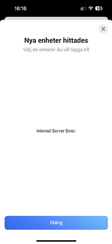

I get internal error when I try to add my 2 Senz WiFi.
I have recreated account and reactivated long and tried all but I cannot get them in homey any more.
They work in Senz own app but not in homey?
What can be wrong??
Ps. I had a major outage this morning but it is only Senz that will not work!!

Hi, could you send a diagnostic report right after you get this error?
It looks like an error on the API side, but want to make sure.
Thanks!

Did you click “send”? I haven’t received any email (yet).
It is working for me.
@Patrick_Hendrickx Can you, by any chance, see why @Bjorn_Rohl encounters this error?

Hi
Just an update.
I tried now in the evening again and all of a sudden it worked. Could it have been some issue with the API connection with Senz?
But it is working now again!
Br
Björn
Seems indeed there were some issues on Reychem side, also saw all thermostats in error state and few hours later suddenly all is fine.
Now it seems the API is down again.
https://api.senzthermostat.nvent.com
Hi our IT department is on it. It seems there are some issues indeed. I think they are restarting the server. Everything should be solved within half an hour. Sorry for the inconvenience.
