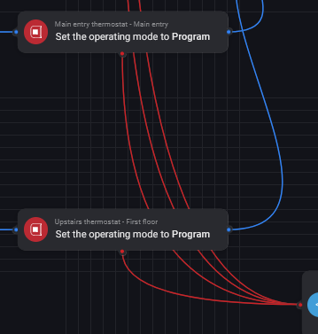

Yep, via Error in advanced flows I guess - just tested recently when I tried to change temp on 6 thermostats in parallel, I know that it reported API error.
But best would be basically to execute and then check set value…

The last couple of days my flows stops with error when trying to set mode. Setting temp works fine and i have tried the repair so the token works.
Anyone else?

Did some more testing.
In homey i can change both mode and temp on all units (3) when i open them up. The change shows within 0.5 seconds in the mobile Senz-Wifi mobile app.
In flows none of them can trigger a mode change and all of them can trigger a temperature change.
