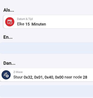

I read in a post that the Qubino plug does not update its kWh at all. I have that same problem with 2 of those devices. That would be fixed with a firmware update? Is that true?..
I did send a email to Qubino bij there website.
I did receive instruction for updating the plug. I must buy a Z-wave stick otherwise it was not possible.
Otherwise I could try to make a flow for updating the plug for the KWh.

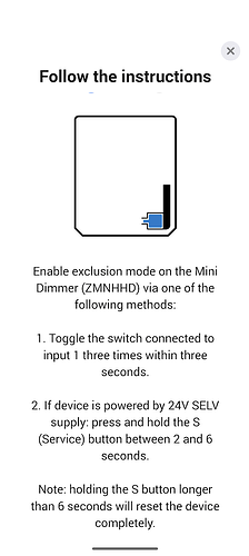

I have just installed a new homey pro running v11.1.0 and app version 8.2.0.1481. I am trying to install a mini dimmer (ZMNHHD) which was on my original homey from 2018. I attempt to enter exclusion mode either by toggling the switched live 3 times, or by holding the service button for 6 seconds, in either case nothing shows on the app.
My first question is whether the fairly elderly module is compatible with the latest homey and app, especially as there is a move for Qubino to be modified Shelly technologies as time goes on . Also should I be trying a full reset before install? Is there anything else I can try to get the units to pair?
Try to include with the device very very close to your Homey.
I’ve had homey and the qubino within 20mm of each other, and still no joy. This is all I get, with the blue flashing as shown. Is that what others see?
If the app isn’t compatible with the HP23, you wouldn’t be able to install it at all.
Another point to check if an App is compatible or not, is to check the App Store:
I am not aware of any app in which only certain devices are compatible with certain Homey models. So the Mini Dimmer (ZMNHHD) is compatible with the HP23.
I turned off the power to the switch for 10 seconds, turned it back on then went through the inclusion proces and SUCCESS! No idea why but in retrospect power cycling works in so many instances.
