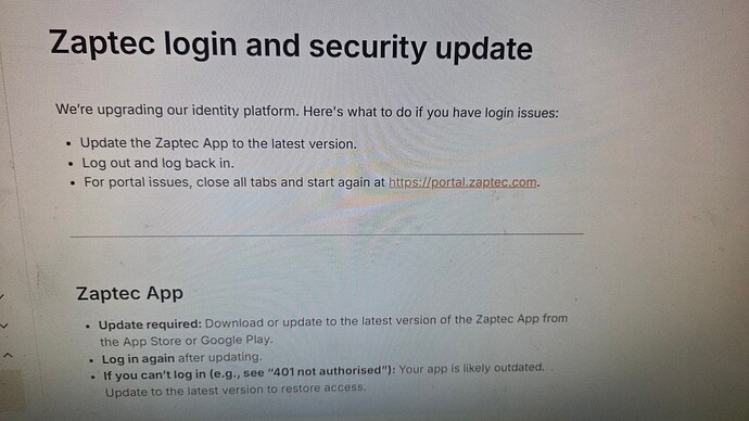

It looks like zaptec have change the authentication method is some way. It is not possible to login using the homey app. See also the statement on their portal.
How can I login again with the homey app? The repair option is not working.

Looks like the app broke two days ago. I’m not able to authenticate the app with Zaptec anymore. They had their own issues with their portal and iOS/Android apps, which they fixed yesterday.
The app should be up and running again with version 1.10.4, thanks a lot for the quick work @pwad!
However, Zaptec still has some rate limits, so to make it work, please do the following:
  1. Make sure to install the latest version of the Homey App which implements the new, not-yet-documented authentication for Zaptec.
  2. Repair your Zaptec device in Homey: log in again with your Zaptec credentials.
  3. If you still receive an error – do not dispair. You’ve already set the first step. Now, wait a couple of minutes so you don’t trigger Zaptec’s rate limit for authentication
  4. After a few minutes, restart the Zaptec app on your Homey Pro
Now, the Zaptec device should come live again and you can use it as before :smile:
