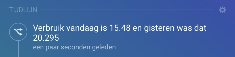

But when I do a report on my timeline with kWh previous day… it tells me 20kWh. What does this report then?
I understand ‘this day’ isn’t finished yet… but kWh previous day should report 28kWh, right?
In above list can you add what PBTH reported? (Check ‘previous day’ insights)
In insights previous day says 20kWh… but also gives 7th of dec… which is today…
I mean, can you add the PBTH values in the table from 2-12 till 6-12.
Note that the insights in PBTH for ‘previous day’ are shifted a day (hence it is called ‘previous’ day :wink:). So the previous day value on the 7th is showing the total of the 6th.

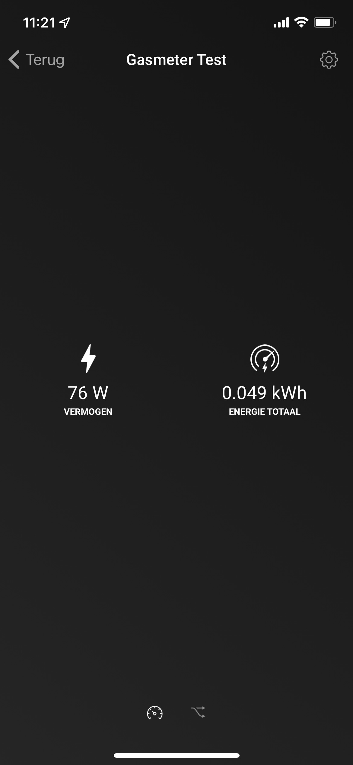

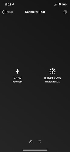

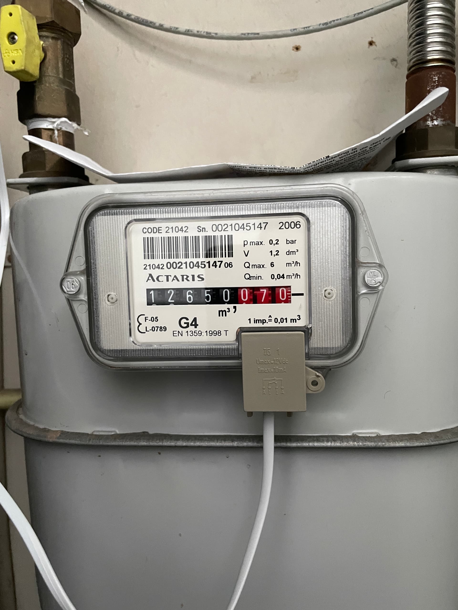

Im using the s0 interface of the youless ls120 for my gas meter (which has a pulse meter) could you maybe add gas as an option for the s0 interface?
I have it connected already but obiously the values are showing kwh or liters
Thanks in advance

You might want to change the firmware of your youless if you want gas capabilities.
