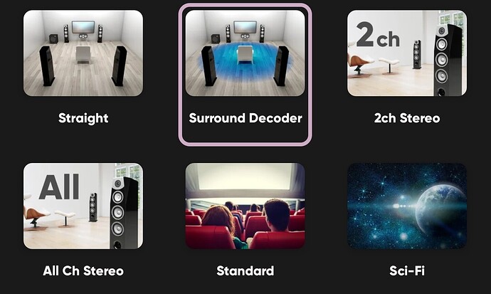

I might just be looking over it. But my receiver has the “all ch. stereo” option. I can’t find this in the “select surround mode” node. Only 5,7,9 and 11 ch. stereo, but it doesn’t know what to do with those settings.
Besides that, “surround decoder” auto sets it to auto mode. Is there a way to make it pick “surround decoder and select which surround decoder you want to use?”
Thanks!

What exatcly is meant? Can you show with a screenshot what you try to select? A surround program?
If it’s the “Surround Decoder” entry in surround mode list, then there is no other possibility. The receiver should recognize the needed surround settings automatically based on the input (cinch input with 5.1 signal Dolby ProLogic II?)

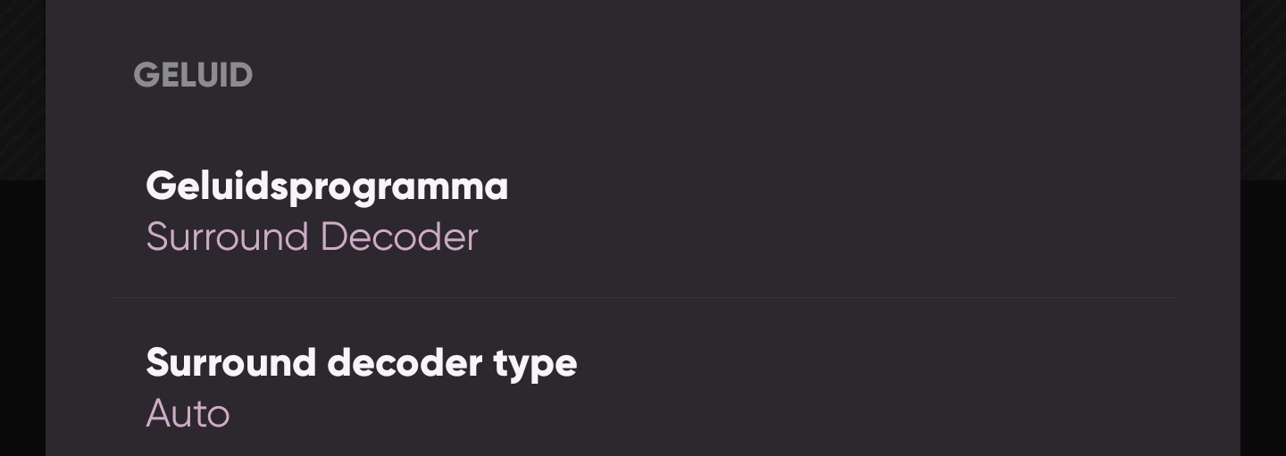

What I meant was the “surround decoder type” in the image I added. It let’s me pick a certain one besides having it auto pick.
Above the image with the first few of the programs. There’s more below, but I think I found most of them on there and don’t really use them anyway.

New test version 1.1.5:
  • Added flow action “Select surround decoder” for MusicCast devices/zones.
    I only found surround decoder settings for the MusicCast API. For AV/XML API I haven’t found it yet.

Awesome, that’s exactly what I meant :slight_smile:
DTS NEO Music is what I was after for some music listening :slight_smile:

New test version 1.1.6:
  • Added ‘All channel Stereo’ sound program for MusicCast devices.
grafik
@LexvV FYI
All is working correctly now. Nice job. Thank you
