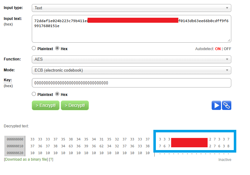

Trying to connect my Roborock S8 Pro Ultra. Using a un-ecrypted icloud backup and SQlite, I retrieved the 96 character encrypted token:
Using the AES Encryption – Easily encrypt or decrypt strings or files site, I decrypted the token:
But when using the decrypted token 33…38, I’receive the following error:
What I’m doing wrong?

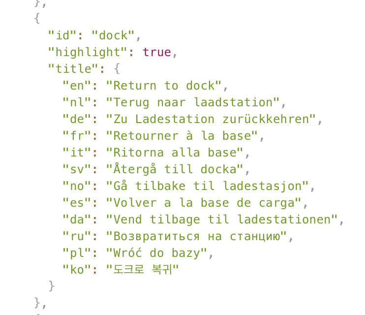

I am trying some new automations and I am really missing one status. It would be perfect if there was also a status for when the vacuum is done vacuuming, so the status before it has reached the dock and is charging (Aan het opladen).
I don’t know if this state is even available but within the Xiaomi app it shows “returning to dock”.
Could someone confirm if this state is available via the API? If so I’ll create a feature request via Github :slight_smile:
Not sure it’s there but what do you need it for ? Eg. I’m actually using “Is charging” because that happens when vacuuming is done :wink:
Most vacuums support a go charging state. But it’s not available in the vacuumcleaner_state capability the way Athom implemented it in the Homey SDK so I cant match it. If you are gonna submit feature request you should submit it at Athom HQ.
Aaah thank you! That’ll probably take a while even if they want to implement it. But will request this feature via them then :slight_smile:

Correct me if I’m wrong. But if I’m correct the state is available within the Homey SDK.

Have a better look. This is not a state of the vacuumcleaner_state capability but as action card.

Aaah now I see! Sorry and thanks!! Will be chasing Athom after all :wink:
