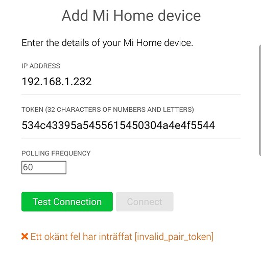

I am testing to add a vacuum cleaner but that app does not recognize the token, which I know is correct.
Do anyone have a clue?

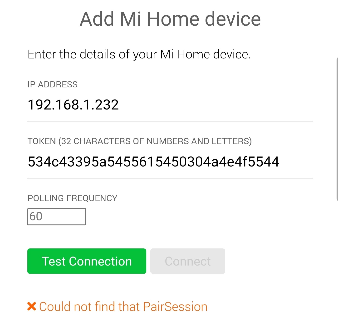

Also, when I retried this, I get a different error message (couldn’t find pairsession, which I suspect is that it couldn’t find the device at that time?)
I restarted the app and tried again, and get another error message.
I assume my vacuum robot is not supported, which maybe isn’t that strange. My robot is of a sister brand to Xiaomi, a Dreame L10 Pro. It has not an android app of it’s own, it uses Xiaomi’s Mi Hole app just as a roborock or Xiaomi vacuum robot.
Anyone here that might know a solution or even have a Dreame D9, L10 Pro or similar robot from Dreame?

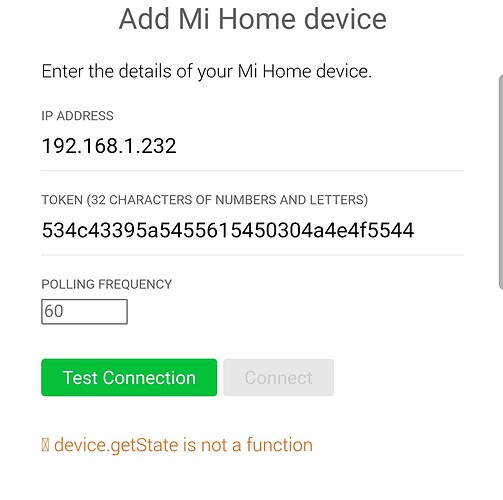

Anyone is unable to add Roidmi Eve + vaccum in Homey ?
When i want to add, i have the error ‘device.getState’ is not a function.
I already send an email to the developer, but i don’t have any response.
Thanks for your help.
It means the device is found but not supported. You could try to add it as one of the other vacuumrobot devices to see if that works.

I’m trying to add Mi Smart Humidifier v1, and I get one of those errors:
Could not find that PairSession
device.power is not a function
Could not connect to device, handshake timeout
I tried to find out what can be a problem and I found out that miio seems cannot find token, because it shows “???” But I managed to get token with another app. So I wonder if miio cannot find token, does it mean that this model is not supported?
