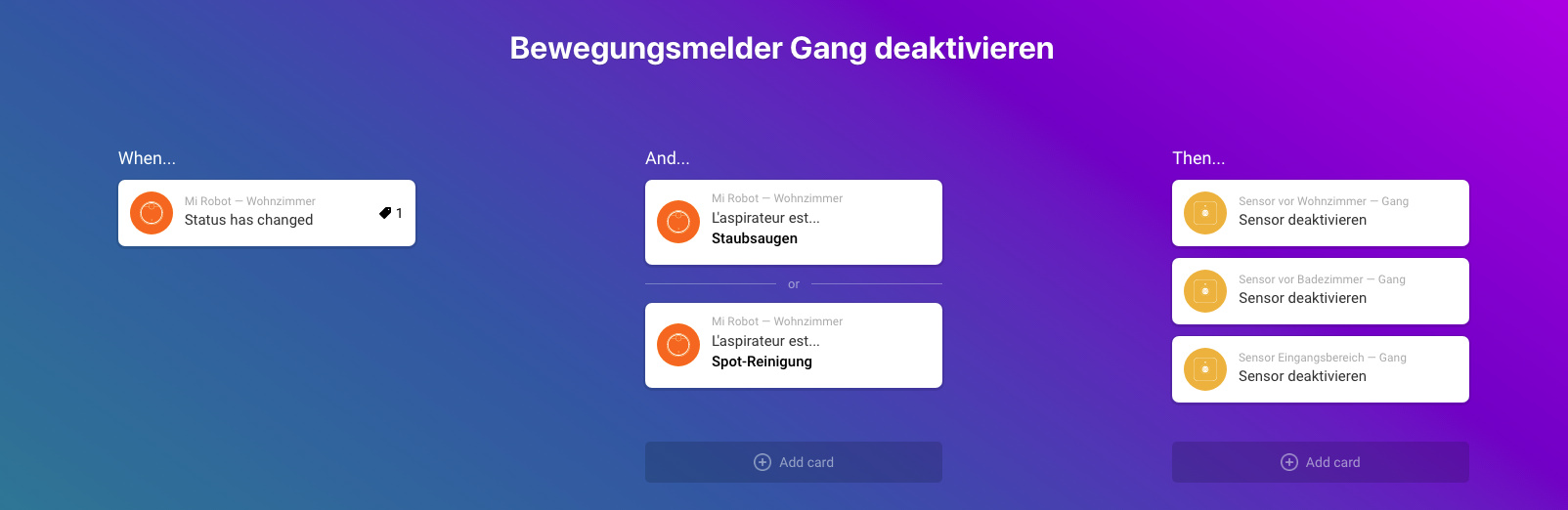

My Roborock S50 has a multiple personality disorder, at first it was only English and German, now also French has been added :crazy_face:
Can we somehow help with the therapy?
The app is only translated in English and Dutch. Any German and French comes from Homey itself for the default card for capabilities. This is something you should report at Athom HQ.
