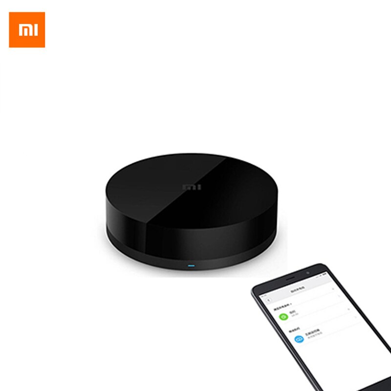

Will there be support for the nee xiaomi ir remote?
Wanna use it for me aircoâs
Yes
No and new products wonât be added as development of the underlaying miio library has stopped.
Sorry, this is to sad. is it any development plans?
You can ask the author of the miio library here: GitHub - aholstenson/miio: Control Mi Home devices, such as Mi Robot Vacuums, Mi Air Purifiers, Mi Smart Home Gateway (Aqara) and more
(I did not code this library myself)
