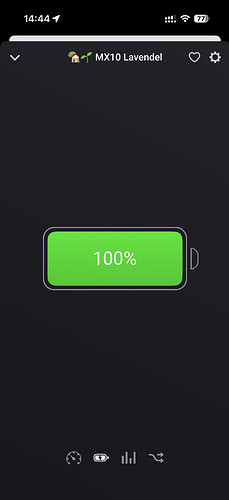

@Koktail do you maybe know how I can debug the following issue? I have the underneath flow. When the battery percentage of the Xiaomi Mi Flora (normal, not max version) becomes below 20% I get notified on my phone and added an notification on the timeline in Homey. But both notification showed 100% as the percentage.
Is there a way I can debug this issue to see if the correct value is really being passed? I also added a screenshot of the graph of the battery percentage of this sensor from the last week, where you can see it is getting lower and lower, not even 100%. The other screenshot is of the information tile (or whatever it is named) shows the correct percentage as we also get from the graph.

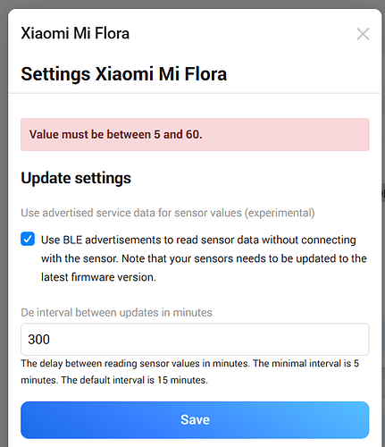

New to this thread. Have searched but not found any reason as of why I can’t set a longer ‘interval between updates’ than 60 minutes. I used to have it at 300 minutes and was happy with that to save battery of the sensors.
Is there a reason for this limitation or is it possible to get a longer interval back?
60 seconds probably, or do you really mean 60 minutes?
Today
Now maximum interval is 60 minutes. I would like to be able to have a longer interval if possible?
When you have BLE Advertisement on, it’s controlled by the sensor itself, so I guess this “interval” do not apply at all (if I’m not mistaken, it’s 15min interval by default)
Okay!
I tried BLE Advertisement. It didn’t work for me got the flows disabled because they executed too many times.
If I disable it it is still not possible to set a longer interval then 60 minutes. Would it be possible to increase that limit to something like at least 1500 minutes?
That should not happen anymore, I think Koktail was fixing that. You are on latest version ?
It’s hardcoded so unless Koktail will change it, then not.
Possible workaround - disable app as you need and re-enable on certain intervals.
