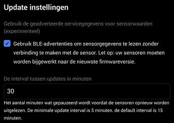

My setup is fairly simple: I have only one plant sensor. I configured the app as follows:
I have one flow checking for below threshold situations and another one for above threshold situations. This is the trigger part of the former as an example:
Do you have any idea what could be the cause of this?

Just a FYI: I bought 2 MI Flora sensors a couple of weeks ago and could not get them to update on my 2023 Homey Pro. They worked just fine in the Mi Home app, but would never update once they had been added to Homey.
The solution for me seems to be to get the latest test version of the app and enable the BLE advertisements setting! At least I see regular updates now.

  • since connection to the sensor itself were never working reliably, I’m using new option “update sensor values based on advertised service data” introduced in Xiaomi Flora App v. 4.4.0
